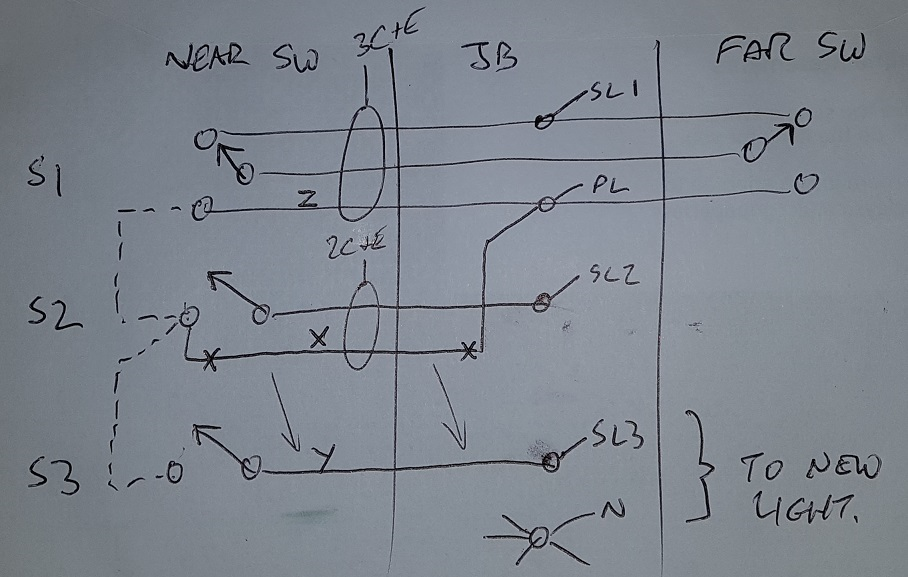

Hoping someone can help me with a lighting circuit challenge.
I have an existing two gang switch, with one 2C&E cable for a simple circuit and one 3C&E for a two-way circuit (using conventional 3 control wiring). It's an older property but pretty conventional loop-in loop-out radial circuit, using junction boxes.
I want to add a third circuit (low voltage under-cupboard lighting), replacing the two-gang switch with a 3-gang. The new circuit will be a simple one-way switching.
I have good access to the junction box, but cannot easily run a new cable to the switch - the existing cables are embedded in plaster and the wall is tiled.
It occurs to me that, in theory, I do have sufficient wires for the three circuits, if I use a single live wire for all three. I.e.:

Yes, this is important. You mention two or three circuits - you do not have enough cores if there is more than one actual circuit, because no parts can be shared. If it is all one circuit and you mean two or three lamp loads on that circuit, then you do have enough cores.
I infer from your post that the SL and PL of the 2-way are the strappers L1 & L2, and the commons of the two switches are simply linked. In this case I would use the 3C+E as L1, L2 and Com of the 2-way, pick the feed for the other two switches up from whichever of L1 or L2 is the PL, and make the 2C+E the other two switched lives from those. This makes the 2-way wiring conventional and easier to follow.
If instead L1 and L2 are linked, and com at one end is PL and the other end SL, then you would need to ensure that the PL is at the end with the additional switches and the SL the other end, or reconnect as the drawing above.
If the cables from the JB to the switch follow the same route, there is no harm in current from one cable returning via the other - it will not generate interference. If they follow different routes, then the unbalance of current can create mild radio interference if a dimmer or certain kinds of LED driver are in use. To avoid confusion, it is absolutely unacceptable for current from one *circuit* to return via another *circuit*.

Many thanks for the replies, and apologies for my confusing use of the term 'circuit' - rest assured it is all a single MCB circuit, just three lamp loads. (No borrowed neutral!!!)
I think Lucien has reassured me that it's fine, since the cables are taking the same route. And yes, the two-way is wired L1-L1 (PL) and L2-L2 (SL), so I'll do as you suggest.
