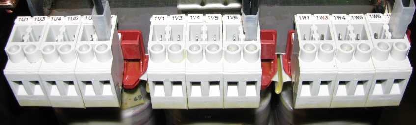

Here are the indications : [ElectriciansForums.net] Connection of a 3-transformers power supply to the 220V and the transformers connections :
Any help would be greatly appreciated.
looking at your photos i would say 230/240 V between any 2 or your 3 connections will give 24VDC, check siemens website, its very good.
Live to 1U5. Neutral to 1U2. it will be single phase only so watch the temp of the transformer
Thanks Tony for your answer. It works !
I suppose that you meant without the jumpers, because it works with or without them.
I studied the circuits and found out that only the U transformer is used (That's what you said: Single phase). I suppose that I can't use all 20 Ampere (secondary) in this way.
Wouldn't be possible to connect all 3 transformers in parallel to the monophased 220V to have the full power ? Maybe this is a stupid question, but I don't know a lot about triphased networks.
Hi SirKit Breaker, the good price was 17 pounds on an auction website :D for a brand new device
Don’t try all three legs of the transformer on single phase. The magnetic flux of U, V & W will cancel each other out. Either you will blow your supply or toast the transformer. Also don’t fit any of the links, you will short sections of the windings out causing the transformer to burn out.
