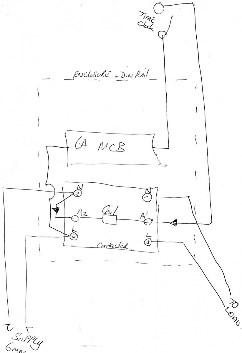

Hi,
Just wondered..... Is it ok to supply the coil of a contactor from an FCU from a socket circuit or does it need to be a seperate circuit? This is going to be via a timeclock.
Any thoughts much apprciated.
Thanks
ah, i see. as long as the cable is correctly protected e.g. 3A fuse, i see no reason why not. but make sure your time clock is compatible with an inductive load.
Oh ok, great thanks. I'm looking at using This Hager es263 contactor. 63 Amp 2 Pole Contactor - 3 Module I know i'l need to fuse it down but how do you technically know what to fuse it down to? will the coil have an Amp rating stated on the contactor?

you coil will take very little current. as for fusing the FCU, the fuse size is selected to protect the cable feeding the coil. e.g. if your coil draws 1a, you could use 1.0mm cable with a 3A or 5A fuse.
If possible, it might be better to derive your timer supply from the main contactor supply, suitably fused down. You can then have one point of isolation for all power into the contactor and its associated load.
Yea this is what i was thinking. It would be better to have 1 point of isolation. So would you fit another 10mm t&e from the supply side of the contactor then into an FCU then 1mm/1.5mm to timclock then back to contactor coils. Is this do-able or would it get awkward? will 10mm fit into FCU?
What are you trying to switch? Out of interest, as you've mentioned a 63A contactor and now 10mm T&E.
if you can, use one point of isolation.

6mm in fcu? tight but do-able.
