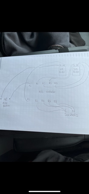

Hi guys , I have to break a ring circuit through a contactor with an emergency stop button .. just want to double check my wiring in the diagram is correct .. haven’t done much of this sort of work so any feedback is appreciated.

I would simplify things and place the socket RCBO in its own garage consumer unit, and the contactor on the supply to this CU.
What is the ring circuit used for? Power tools in a workshop?
Who has decided the Circuit needs an E.M stop and what is the reason for this decision?
Has whoever made the decision thought of the consequences of the EM stop being reset and whatever is plugged in suddenly starting up?
As it would be on 13amp sockets, anything in the future could be plugged in and subject to uncontrolled restart.
Normally anything under Em Stop control would have individual no volt release protection to stop the above happening.
Don't call it an Emergency Stop..... Just a Stop Button.
Next fit a Shunt Trip for the 32A RCBO.

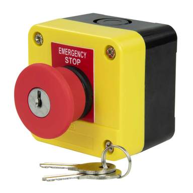

It is a stop button that needs a key to disengage it again
It’s more that when it’s disengaged it turns on again anything plugged in e.g an angle grinder could unexpectedly start up. There is stuff in regs about avoiding rotating machines starting without warning.
A possible solution might be to also change the sockets to non-latching RCD sockets so restoration of power requires each socket to be individually reset.
I still don’t hugely like this though as by adding a facility to stop everything it’s introducing multiple scenarios of a button unexpectedly starting things.

No, to the best of my knowledge that is non-compliant as the contactor will re-energize immediately when the stop button is reset.
There should be a minimum of a seperate reset button.
How far away from the RCBO is the contactor going to be? You'd be better off having a single 4mm conductor from the RCBO to the contactor.
If the contactor is far away from the OCPD then somebody could mistakenly add sockets to the ring before the contactor.
That would still need a seperate reset control.

There's a big issue with the key reset type of E-stop in that human nature is to leave the key in it so that you don't loose it. This means the button can't be as easily operated as it should be.
If someone is silly enough to leave the key in after going to all the trouble of fitting a key to reset stop.

But you can't design a safety system based on whether it would be silly for someone to do something, these systems need to be designed failsafe and if one possible failure is a key being left in an e-stop then it should be designed out of the system.

I should add, The scenario for this wiring is in a classroom situation , for the instructor to kill the power when leaving the room. There won’t be any power tools used in this scenario so there shouldn’t be any reason for issues with anything starting up when engaging the stop button again .
Having said this , will the wiring be ok ?

Emergency switching: 537.4​
Emergency switching should be provided for any part of an installation where it is necessary to isolate the supply quickly to remove unexpected danger.
In installations with rotating machinery, this is usually done by using ‘stop’ buttons. Care should be taken to ensure that the stop buttons are…
  • Near to the machine / equipment
  • Should not be capable of being reset remotely, unless with a key switch.
  • If remote resetting is possible, then the activated stop button must remain activated at the point of the danger until being reset once the danger is removed.
  • In areas where there are untrained people, the stop buttons should lock when operated.
There is a difference between an emergency stop, generally used on moving machinery, and emergency switching off to turn off a few sockets, which is what the OP is intending.
So it’s not an emergency stop?
Just an isolator?
Simple on/off switch to control the contactor would be fine.
The instructor will be the “trained” individual and will know that all machines are off or unplugged before turning on the circuit.

The wiring is fine.
You probably don't need to disconnect the Neutral, depending on the earthing system.
In fact, you don't even need a contactor.
