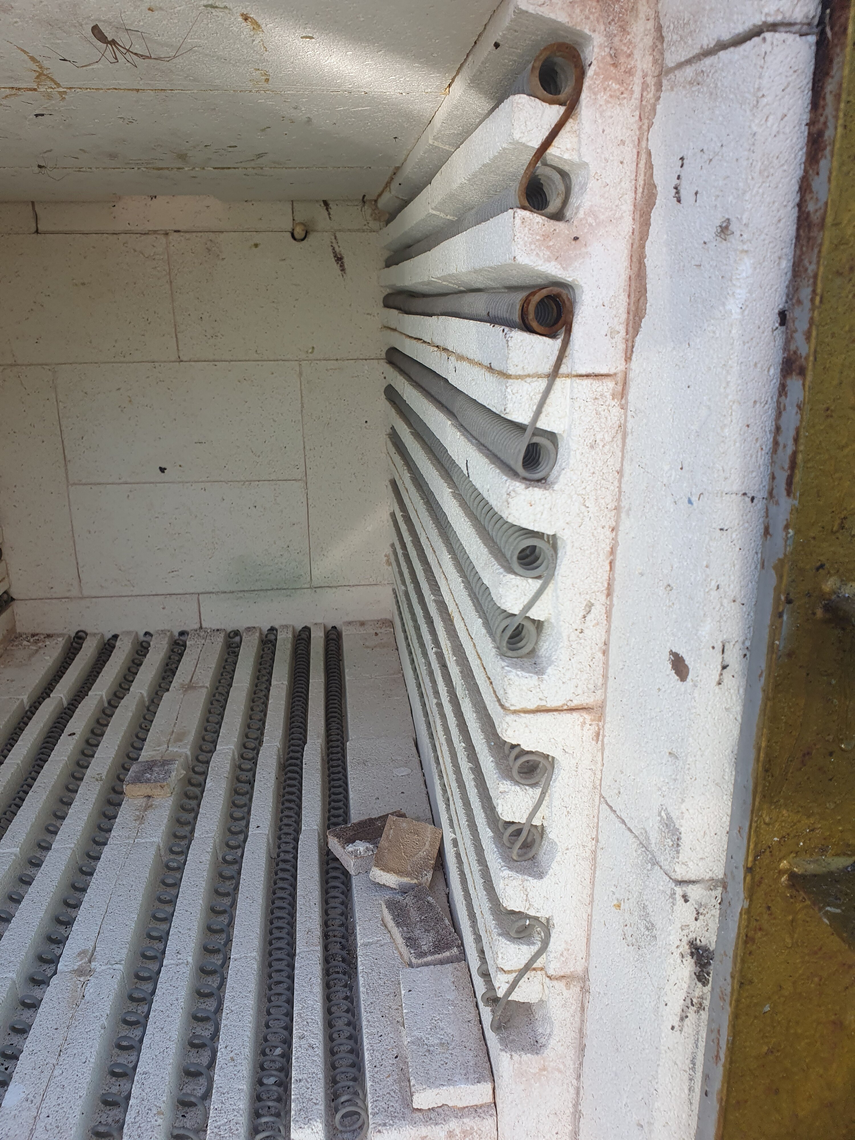

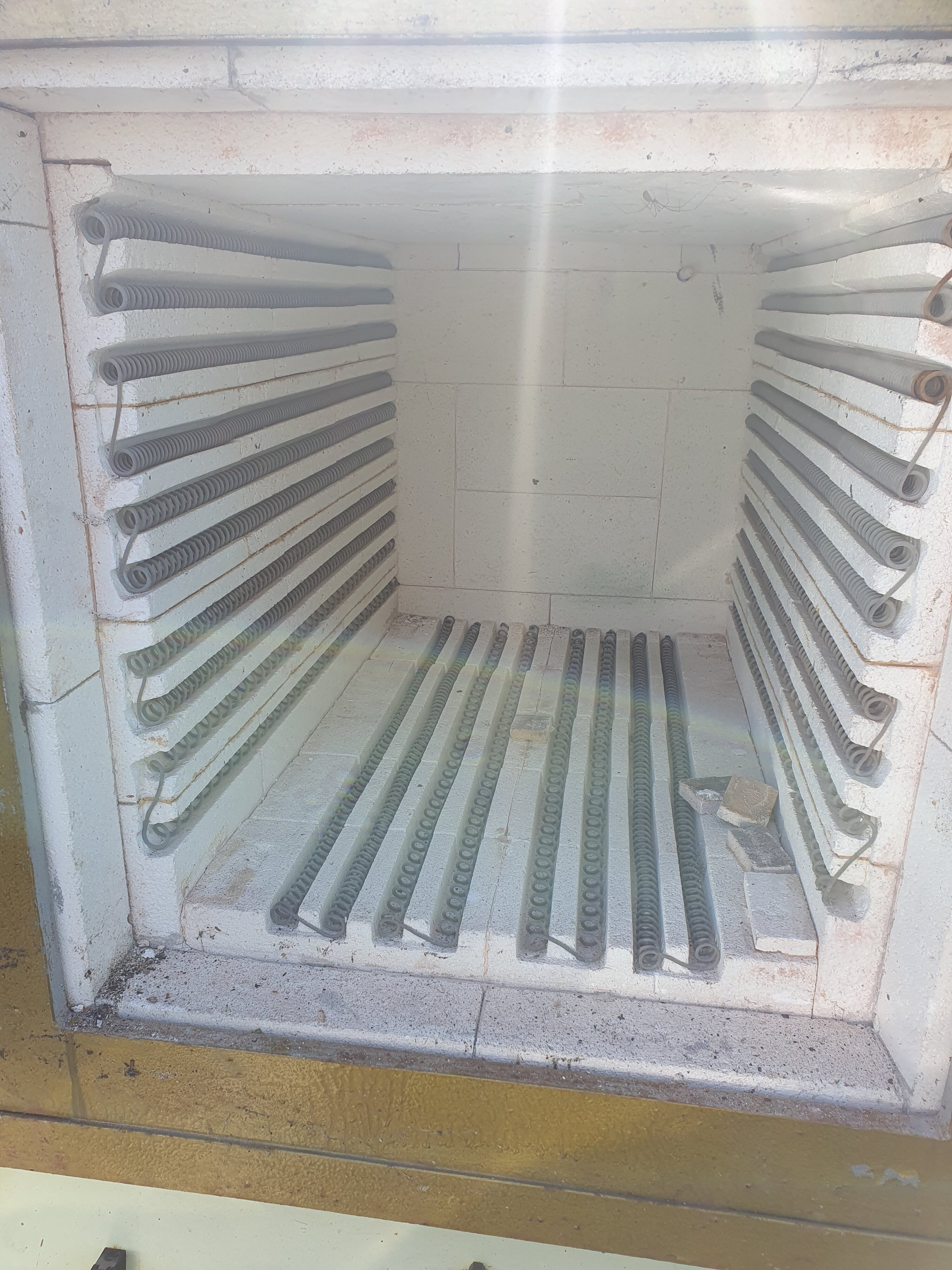

I just obtained a Podmore and Sons 7.5kw kiln (model 3426) which I would guess is more than 50 yrs old, for which there is absolutely no info online. I understood from the seller it was set up for 415v 3 phase in a school but was hopeful I could get it running on 240v by running heavy wires from a 50 or 100amp breaker on my main unit and connecting the elements in parallel. I understand that the ampage will be high but reckon it could work as long as I'm not running shower simultaneously!

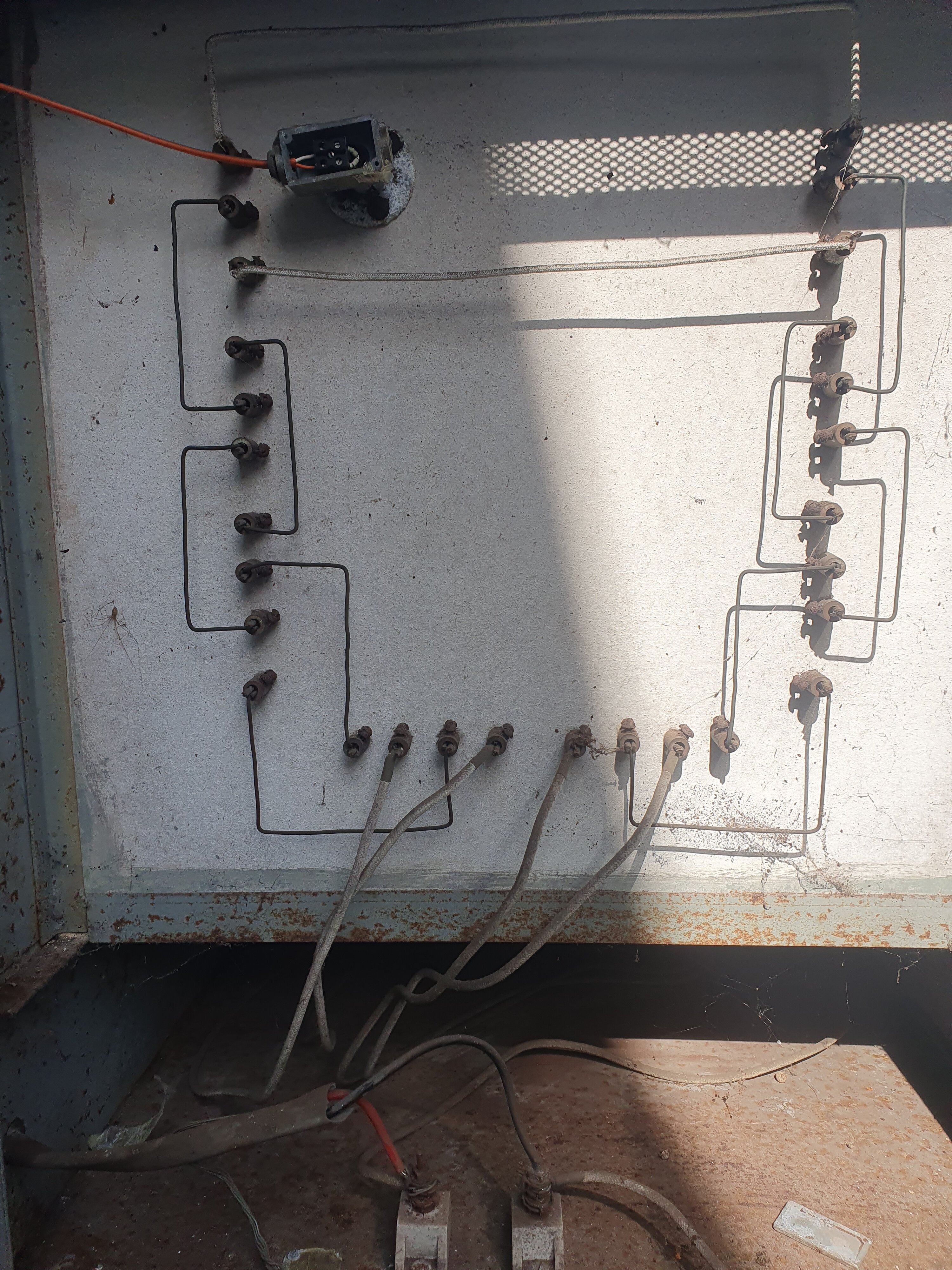

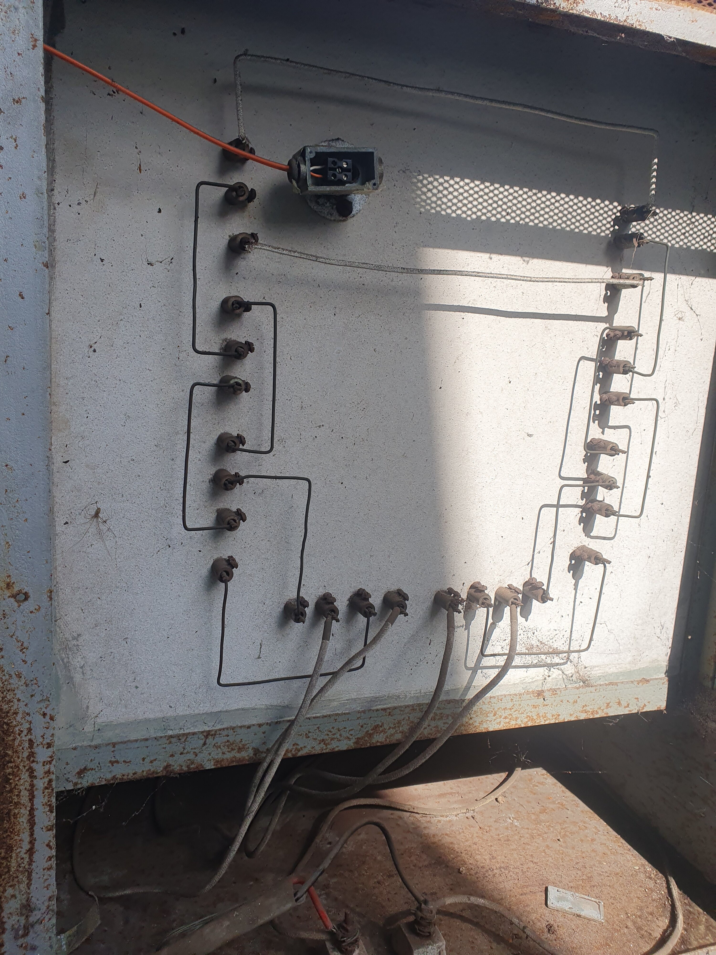

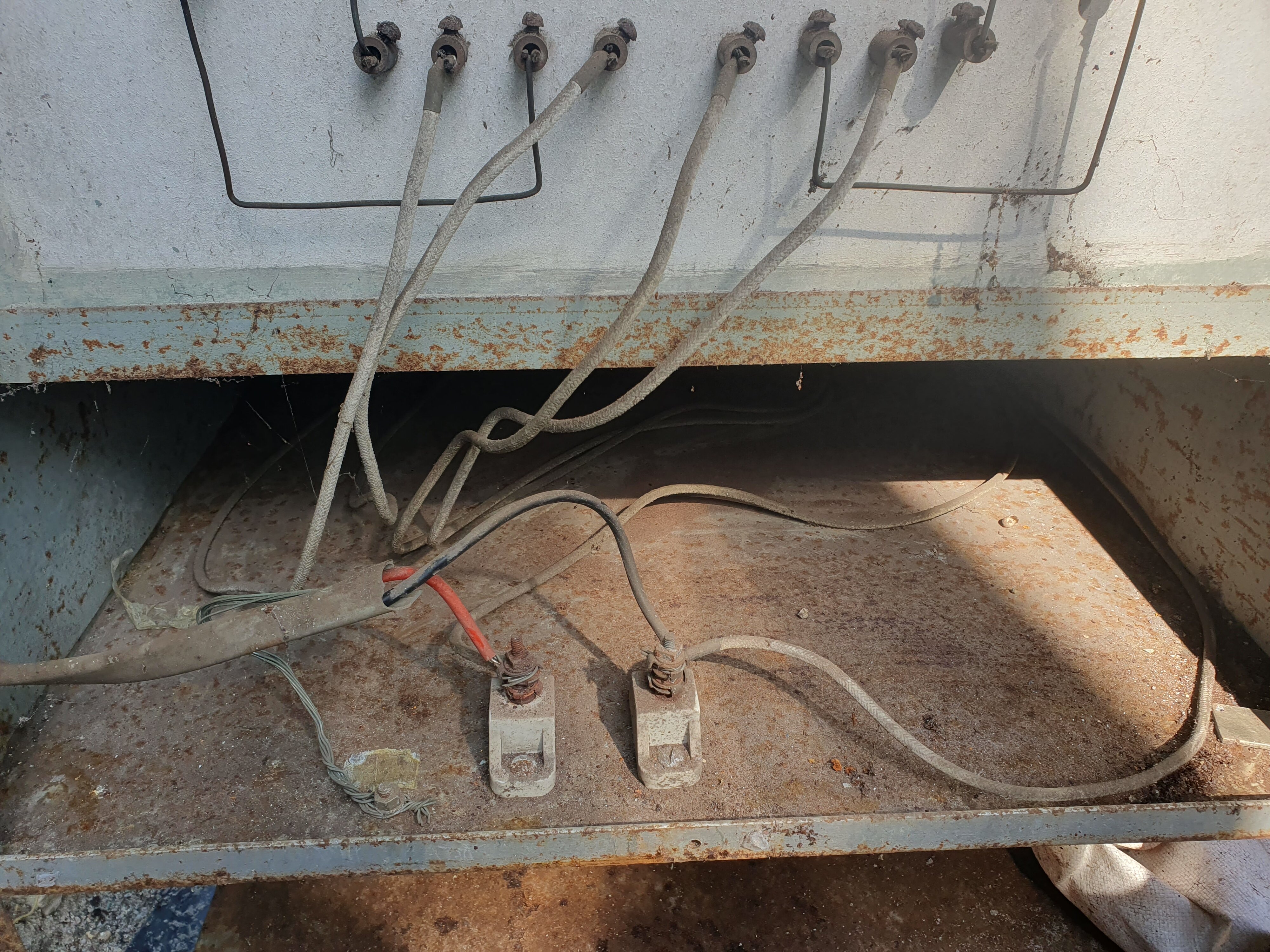

There are two wires running from the inputs to a 3-way selector on the front (marked low-medium-high) and these return to the heating elements as 4 insulated wires. As far as I can tell these feed two separate sets of elements starting with two of the four runs at the bottom and going around (shadows on the right make it look more complex than it is!)

There is no evidence from the picture it was three phase i would get it checked assuming anyone will touch it. Those internal wires probably have asbestos covers.

As others have said this is single phase, a T&E cable is supplying it.

You should get an Electrician for this it will require a new circuit which comes under Part P. According to the specs of a few others of these that have sold it is around 5.8Kw so a 32A supply, however if this states on it 7.5Kw then that would require a 40A supply.
Interestingly they also mention it being 3 phase but being able to be converted to single phase so this would suggest yours has been converted?
I would certainly get this tested for asbestos just to be safe. The fire bricks are not likely to be asbestos but ceramic according to a few pottery sites but who knows given its age (If you find any loose fluffy material between the bricks and the metal housing then this almost certainly would be asbestos) and as westward said those electrical cables certainly could have asbestos material in the outer sheathing and the wiring at the back needs some attention.

I really can't see a problem with it assuming there is a neutral there.
