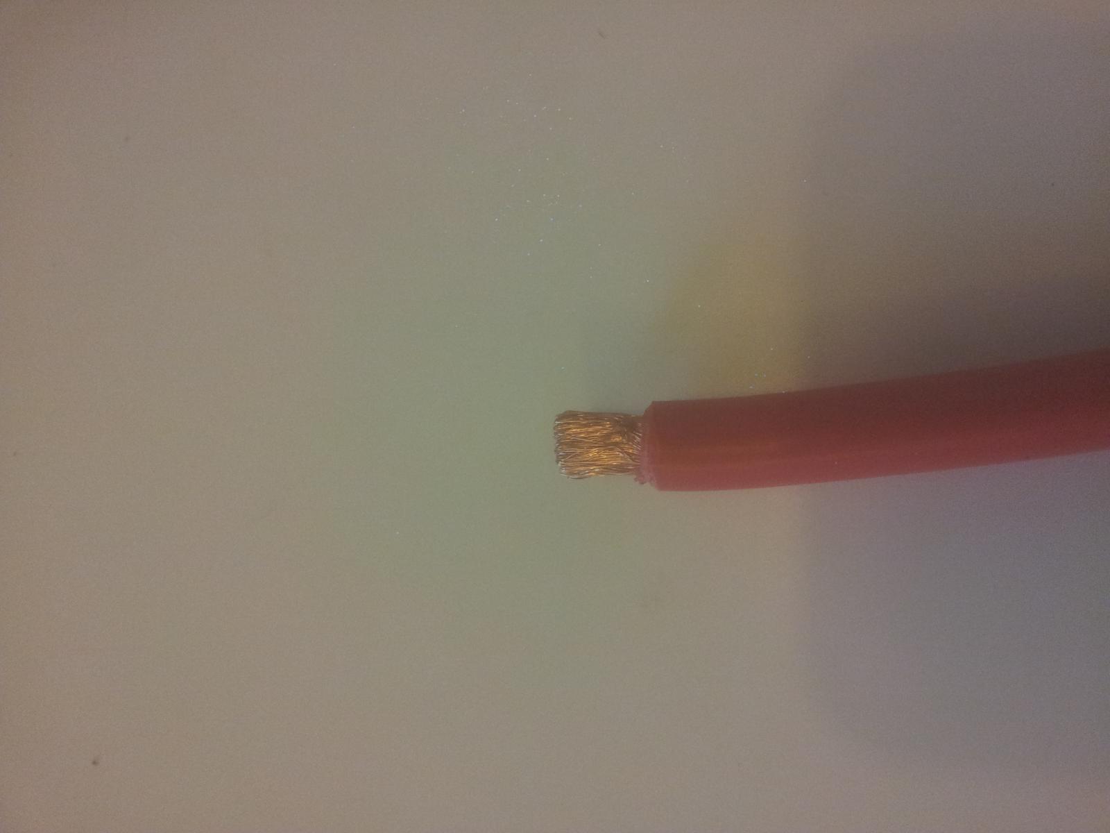

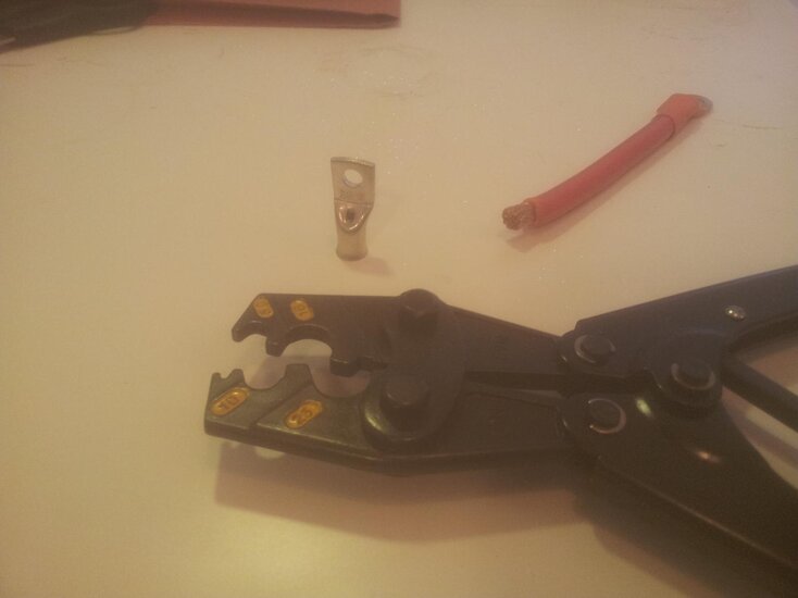

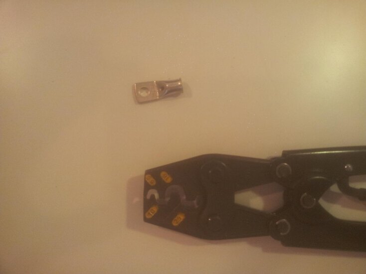

I am about to connect up my 12V battery to my inverter (at last!) and I need to crimp some copper tube terminals on to the end of the cable. I have purchased an indent crimper for these tube terminals but I notice it is different to my crimping tool for insulated crimps. The stem of tube terminal is much longer than the width of the crimping part of the crimping tool. Does this terminal require crimping twice in different places along the stem? And if so, does it require a slightly deeper crimp at the bottom of the stem (away from the hole)?

I have not used one of those crimper,s mine have a much fatter crimping point but I would say crimp at end of the lug first were the cable enters and then give it another crimp next to it , You want the indent to go it to the bottom of the crimp as it is in your picture

That's what I thought first Flanders and then thought it may be best to have a slightly deeper crimp at the bottom so that a slightly thicker piece of the conductor is left above the deeper crimp?

Personally. IMHO I think indent Crimpers are the pits, the majority of my work in later life was installing UPS and Voltage stabalisers etc, using anything from 16mm to 50mm singles.
Most of the stuff we bought and use, specified Hex crimpers, in fact I did hear, can't recall where that indent crimpers were to be outlawed, as being dangerous, not sure if that's still ongoing, but you only have to look at the hex crimp as opposed to the indent crimp to see that the former is far superior.

If you use a deeper crimper setting say the 16mm for the 25mm lug you may cut into the lug I would go for the crimp twice method although saying that the Hex crimpers are better as they squeeze the lug from all directions, Other may disagree but I would give it a good pull after you have crimped it to check you have a good hold on the cable.
