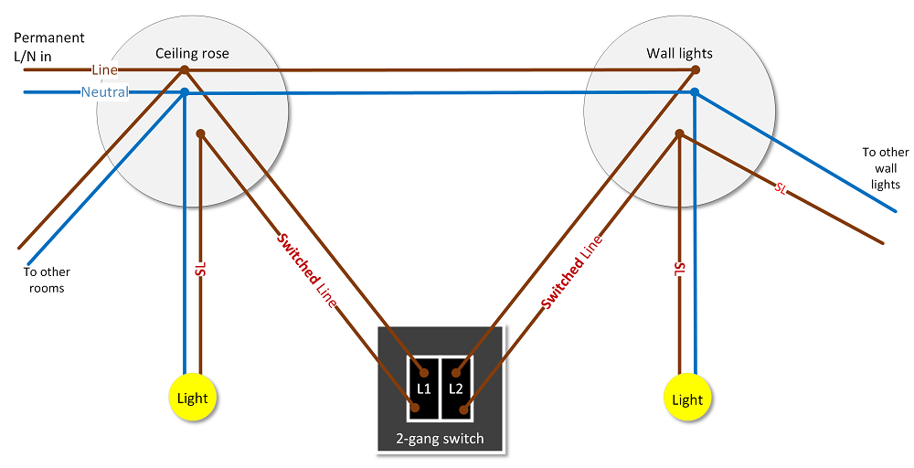

I have a ceiling light and wall light, controlled independently from each other by a 2-gang switch. I have used the conventional loop-in method for my lighting circuit so Line and Neutral goes to the ceiling rose and the wall light and from each of these fittings, Line and Switched Line goes to the 2-gang switch. So, in my switch, I have 4 cores (let's ignore Earth for simplicity) - Line x2 and Switched Line x2.
[ElectriciansForums.net] Creating Neutral in 2-Gang Switch from Conventional T&E Wiring

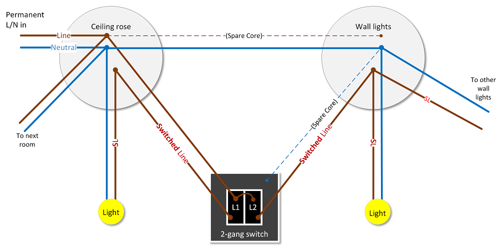

Is it ever ok to share ONE of the Line cores in the switch between both gangs? Thus, rendering the other Line core redundant and available to use as Neutral, by terminating as Neutral at the light fitting?

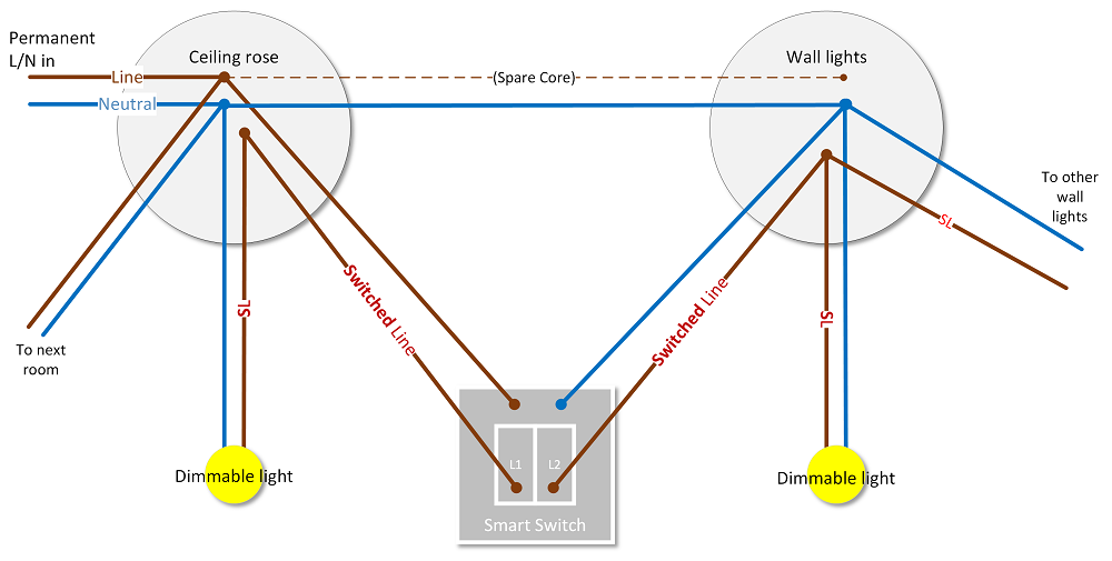

If this is ok/allowed (not that anybody would need/want to do that in reality), surely it opens up the possibility for me to do this in a smart switch, which has 4 terminals (L, N, L1 and L2)...
The risks I've considered are as follows:
  • MCBO shouldn't kick off as the 'sharing' of the line is on the same circuit (even in the same room) so the current on the Line core into the room should be the same as the current leaving the room on the Neutral core, irrespective of the slight deviations it's taken within there. right? Does the length of the cores have a significant bearing on this, as far as a 30mA MCBO is concerned?
  • Would either of the Line or Neutral cores become potentially overloaded in this setup? The smart switch itself is 1W and the LED bulbs on the ceiling light fitting would be around 30W and wall lights around 36W.
Is there anything I've completely misunderstood? Any help and advice would be greatly appreciated.

so presumably you'd fit a link in the switches (common-common) to reinstate the perm L to the switch from which you have pinched the L . at first glance, i can't see a problem as long as cores are sleeved according to their porpoise.

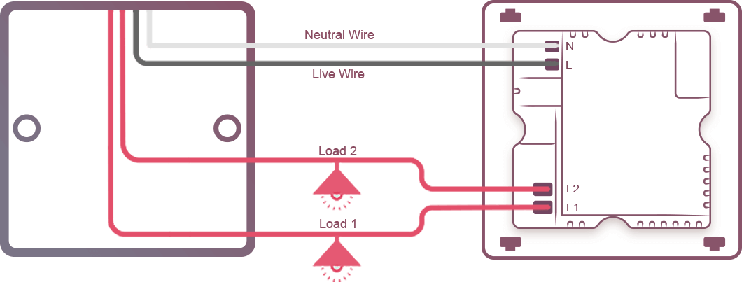

These are the terminals on the back of the smart switch that I like:

The RCBO won't be affected by the change at all, unless you fit additional smart switches and they leak earth current. (You have not shows the CPCs in your diagrams, which was probably the best for clarity, but I assume that the smart switches will also be connected to the CPC). If you have a lot of smart switches on one lighting circuit and they all leak a couple of mA to earth, you might have the RCBO trip.
The length of the conductor doesn't affect the operation of the RCBO, but you should check that the new route doesn't result in a voltage drop that is above that allowed in the regs. (3%). I doubt it will be a problem because the new route to the final ceiling rose won't be very different to the old route (in terms of length).

Thanks all for your responses. Just spoken to my electrician who has confirmed most of what you've all replied with above, except Archy's reply to Telectrix about linking the COM terminals:

FYI Archy, what Telectrix said (and what Risteard was more colourfully getting at) was correct - you only need 1 Line conductor in a switch, regardless of the number of gangs.

There's nothing wrong with having done this - it was just never necessary. However, having done it, it's turned out pretty lucky that I have a spare conductor in the back box that I can now use as Neutral :)
