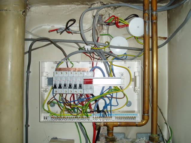

Cheers guys, will get some pics for you. On a related note the original board has what looks like 6mm tails powering it, yet they are 16mm from cut out to the meter. A first time for me, is this a common occurance?
quite probably had the tails from cut-out to meter upgraded by supplier, but tails from meter to CU not their responsibility.
