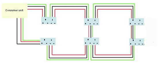

HI, as my profile says I'm not a sparky and know my limitations. I'm trying to learn (for the sake of it only as I'll never do it) what tests for "Ring Final Circuits" are. I understand how the Tests 1, 2 and 3 are done but in one of the videos I watched the presenter (John Ward) mentions a "crossover" see image and says that this "could lead the current being shared in an undesirable fashion. I don't understand that.
[ElectriciansForums.net] Crossover in ring circuit
The ring is a bit of an historic artefact, but a good one in my view. With the middle cross over it is no longer possible to perform a single test end to end. It doesn't improve the current capacity but it does make it much harder to test. My quick thought is it won't ruin the current handling capacity of the ring, but it's not the construction method shown in Appendix 14 of BS7671.
It's not done strictly in accordance with the good book, but there are worse arrangements!
The major issue is that, when you do testing on a ring final, you crodd connect the conductors in a sort of figure of 8 arrangement. Then you test at each socket and check the R1+R2 resistance. In a properly installed ring final, the R1+R2 at each socket should be more or less identical.
The circuit would fail this test because of the the 'lollypop' arrangement in your post.

TBH I cant really recall any damage to cables on any of the hundreds of incorrectly wired rings I've come across over the years. In fact in the domestic sector it's pretty rare to find a correctly wired ring unless the house is fairly recent. The one I'm rewiring at the moment has spurs off spurs off spurs in the kitchen (now ripped out), no sign of thermal damage at all.
I think in reality it's highly unlikely that an incorrectly wired ring in a domestic setting would ever see high enough loading of sufficient duration to actually cause any cable damage. Seen a fair few 2.5mm^2 and even a few 1.5mm^2 radials on 30A/32A OCPDs and don't recall seeing any evidence of overload damage. Obviously, it's not good though!
