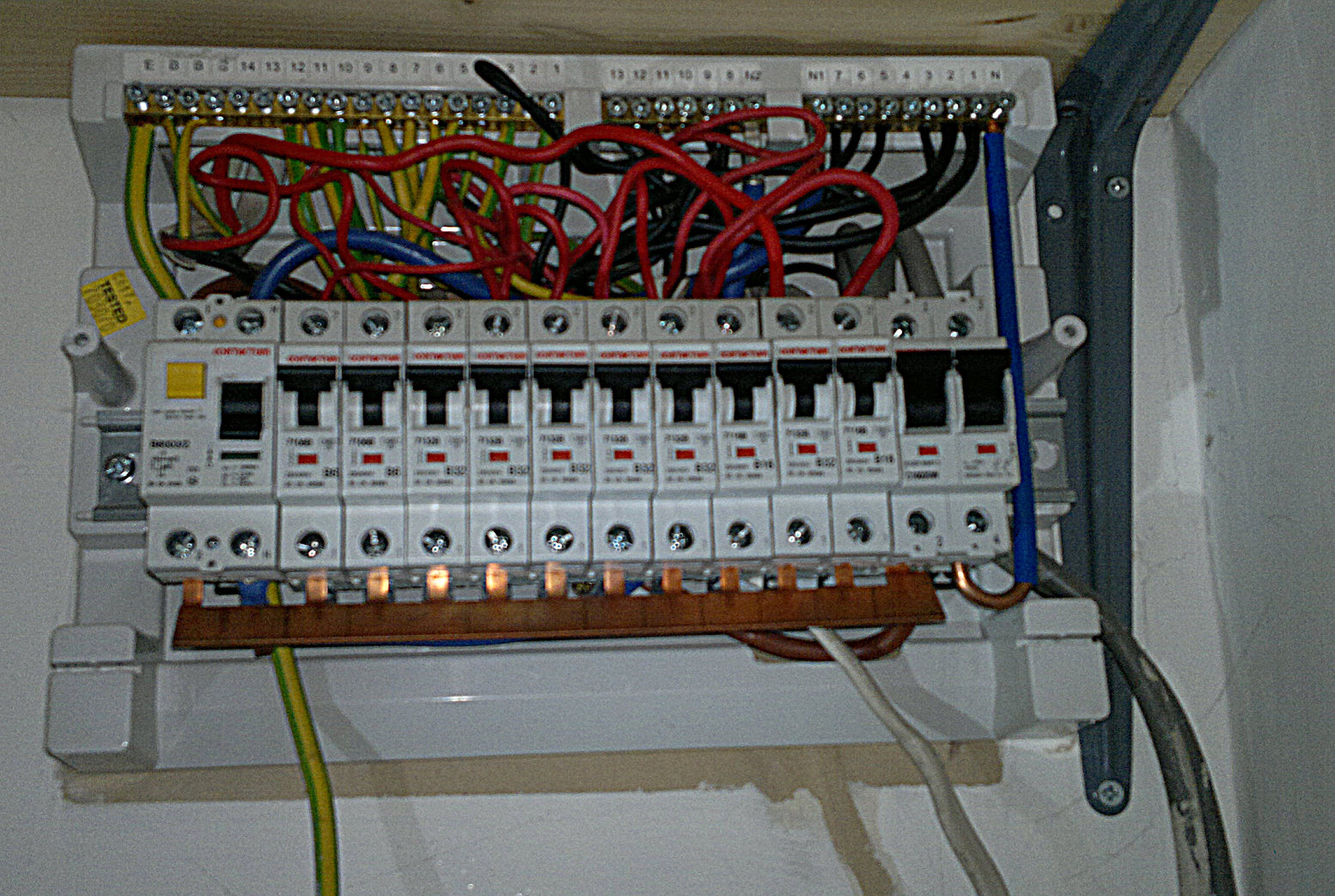

Went to look at a consumer unit this evening, the owner is having trouble with the RCD not working, notice anything odd about the installation?

busbar gives it away. all breakers are fed direct from main switch and looks like RCD L on both in and out is connected direcly to main switch Lout. .
Yes, RCD L in and out are indeed both connected to main switch L out.
The owner has already had 2 electricians visit, one said the CU needed a new RCD fitting, other other said it needed completely rewiring ...

The rcd spur being fitted is probably because there wasn't rcd protection of that supply.

The legs on the bus bar are too long for the new rcbos
