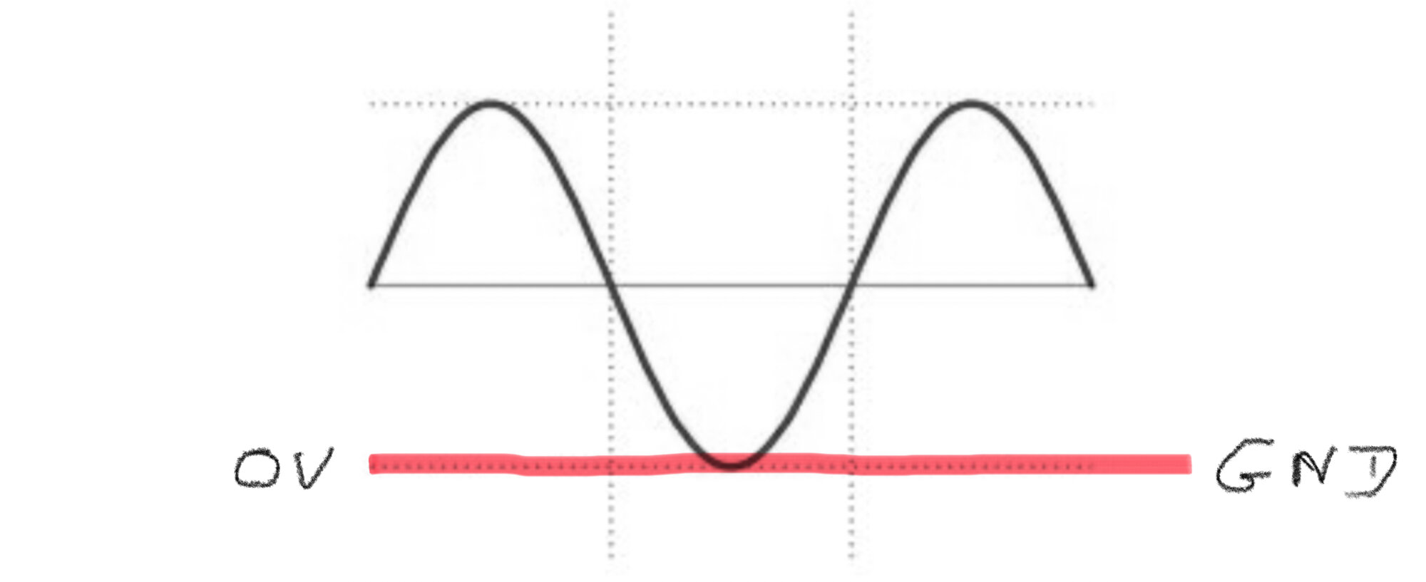

Okay I’m feeling like I’ve got abit more knowledge than yesterday now, but I have another question now ?
So during the negative portion of the sine wave, voltage is moving from the neutral through the load to the line ? If this is the case would you get an electric shock from touching a neutral ? For example if you turn the MCB off to do maintenance to a socket. The socket is safely isolated but if it’s still in the neutral bar and the current is alternating into the bar wouldn’t there be a risk of electric shock ?
Almost there but still not quite.
Rather than thinking of the negative half of the sine wave as 'putting voltage on the neutral', what actually happens is that voltage is still on the active wire, but now it's negative to earth reference rather than positive. The neutral stays at 0V as it's bonded to earth reference.
