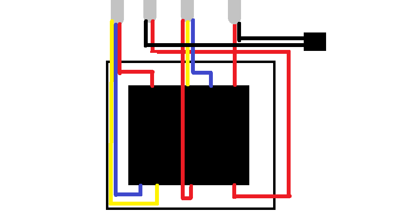

hi i have a 3 gang switch currently in the living room, The first switch is a one way to a light outside that is no longer used. The second is a two way that is connected to the switch upstairs. and the third is a two way and is connected to a switch the other side of the living room. I want to get rid of the single light outside and change to a two gang system. Any ideas on how i would do this
any help would be greatly appreciated
A few ideas but without looking at the method used to wire up the outside light difficult to be precise. You don't want to be cutting live wires, nor leaving live wires in walls or worse still sticking out.

Thanks for the quick reply this a photo of the current set up the switch for the outside light is the one on the right
not with me now im at my mums. When all switches are on then all connections are live. Turn the right switch off and the top red wire on the right goes dead and the yellow on the bottom. Turn the middle switch off and the blue wire on top row goes dead and the third wire in (the red one)on the bottom goes dead. and if you turn the left hand one of the bottom red on the left goes dead.

View attachment 16161This is what it looks like from the back
seems to me by the drawing you have a permanant feed 3 plate and a switched live 2nd one in from the left and 4th one in from the left not sure which is which. without knowing if theres anything else going on with it i woud say you would be fine chock bocking them individually and leaving in backbox, changing faceplate too a 2 gang.
