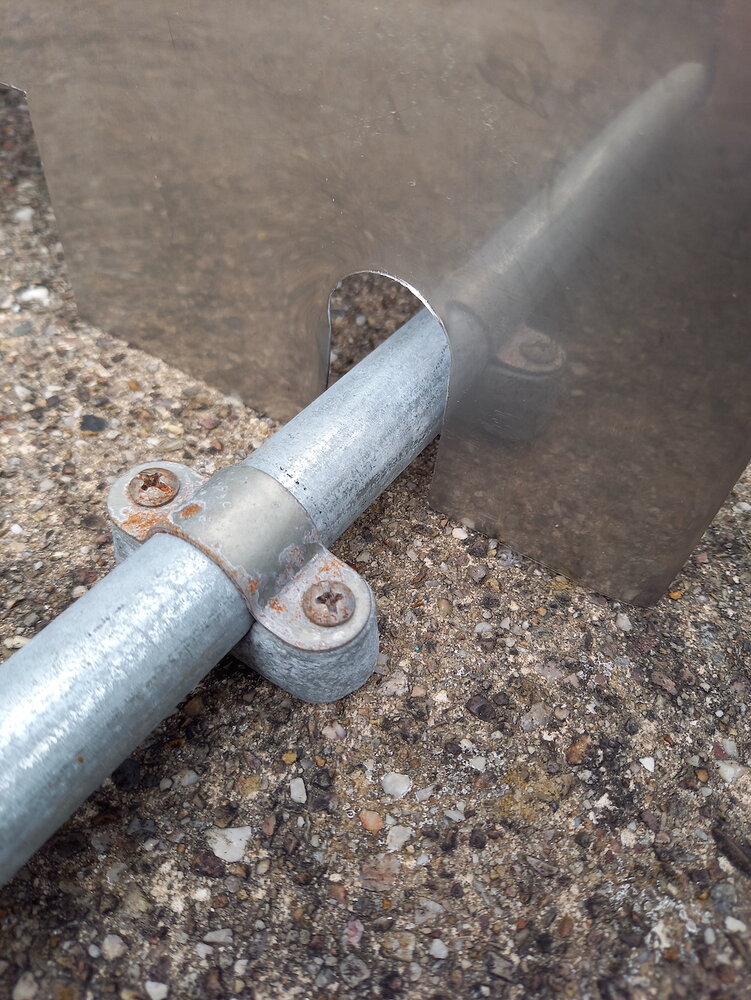

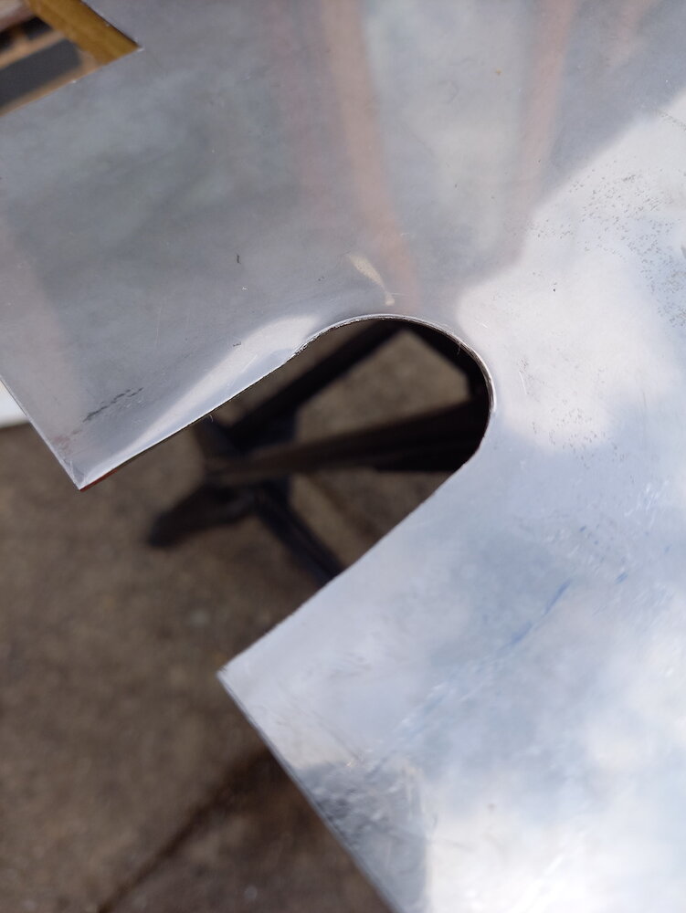

Did some trials on an offcut of 1mm stainless steel sheet.
The 25mm punch worked really well, very neat. Drilled a 4mm pilot hole, then widened to 6mm then 10mm (for the punch bolt), nice and slow, with a bit of water to cool things down.
Tried tin snips to cut: made a nice neat cut, but bent the metal (furthest cut away from the camera on the arch in the picture below).
Tried a jigsaw with very fine tooth blade, on slowest setting, again with a bit of water (nearest cut on the picture below). I learned that the underside of the jigsaw base plate can scratch the stainless steel, so tried another cut elsewhere after putting masking tape on the stainless steel to protect it - that came out fine. A bit of deburring with a file, nice neat finish.
Obviously I made the arch a bit high, but you get the general idea.

Gives me confidence to do it on the client's cooker hood chimney.
Thanks for the advice in the earlier posts, I'll post pictures once the job's done* (in a few weeks) :)
