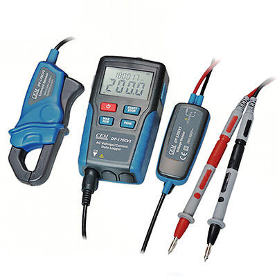

There wasn't too much choice available off the shelf where I live so I went with a ST-175 CV1 Data Logger, I think it's manufactured by CEM who are otherwise known as Shenzhen Everbest Machinery Industry Co. As you may have picked up if you're reading between the lines they're a Chinese manufacturing company and the particular item I purchased had no branding on it whatsoever apart from the model number. The price was ZAR 2250.00 which is equivalent to 120 UK quid and I don't mind admitting at this stage I was a bit nervous but it was supplied by a reputable wholesaler so at least there was a possibility of a refund if not satisfied.

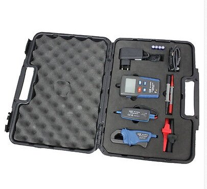

What I got was a full kit with everything you need included, current clamp, voltage leads and clips, 2-pin power supply, USB cable, software disk, operators manual and even the AAA batteries. The case is pretty sturdy and in general the build and finish quality of the tester and the other components was good and solid.

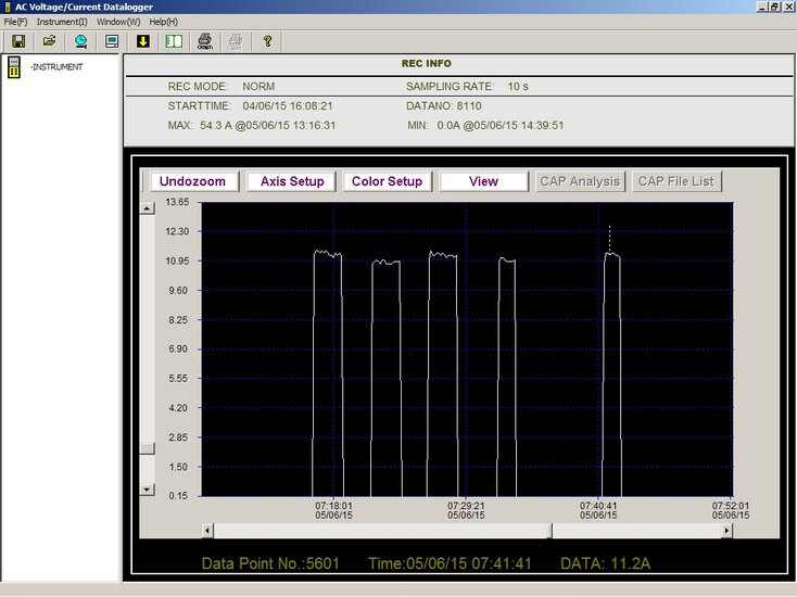

Here's some screen prints of the software;
[ElectriciansForums.net] Data Logger

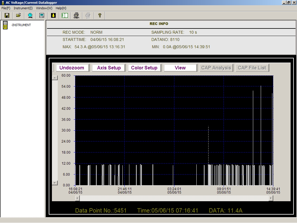

This is a data set from a 22.5 hour logging session on a 2 x 5kW pump water booster station.
This is a zoomed in view on 30 minutes of the same data set. The screen shot doesn't do the graph justice, the vertical lines aren't jagged when you view the graph in the actual software. Some things that are evident from this view are firstly the very steep start indicates the pumps are DOL with no soft starts or Y-D starters.
Secondly the run current starts slightly higher and there's a slight decreasing trend as the pump runs and the head pressure increases, this is a typical centrifugal pump. Also it's a 2-pump setup and they alternate in operation and you can see the sight difference in run currents between the pumps on the graph. Both pumps are identical and running under identical conditions so this might be worth monitoring over time as a possible indication of something more sinister.

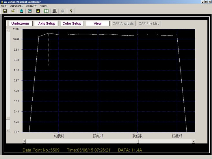

This is zooming in one one of the run sessions. Again the lines on the original graph are not stepped and jagged like they are in this screen shot. The vertical dotted line is where the mouse pointer was and the numerical info under the graph corresponds to this point.

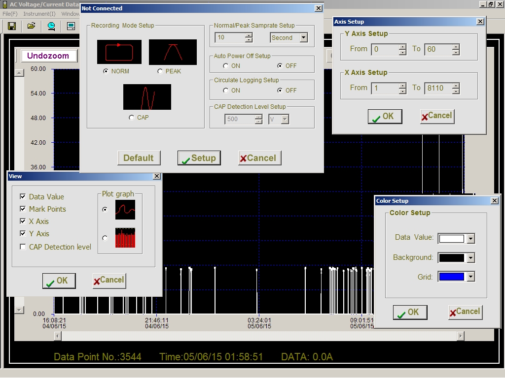

This is just to give some idea of the simple setup windows within the software for customizing the graphing and for setting up the data logger for a logging session.
