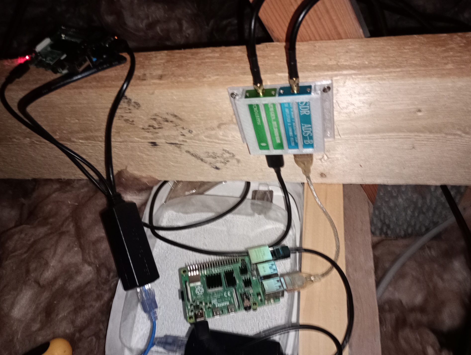

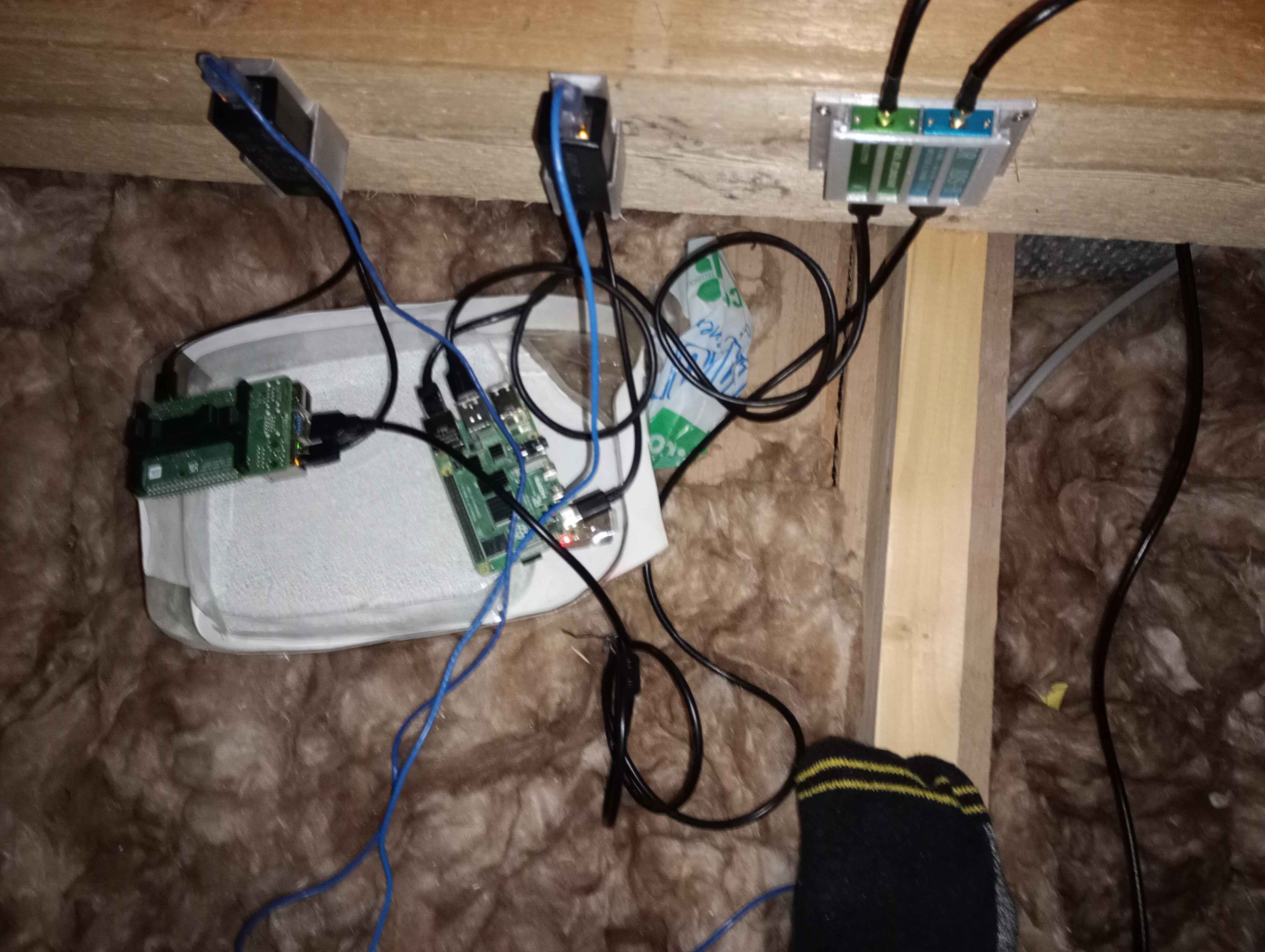

system is currently very much a WIP hence the janky mounting for the raspberry pi boards atm
eventually they'll be getting a case and another custom 3d print to secure them to the joist also

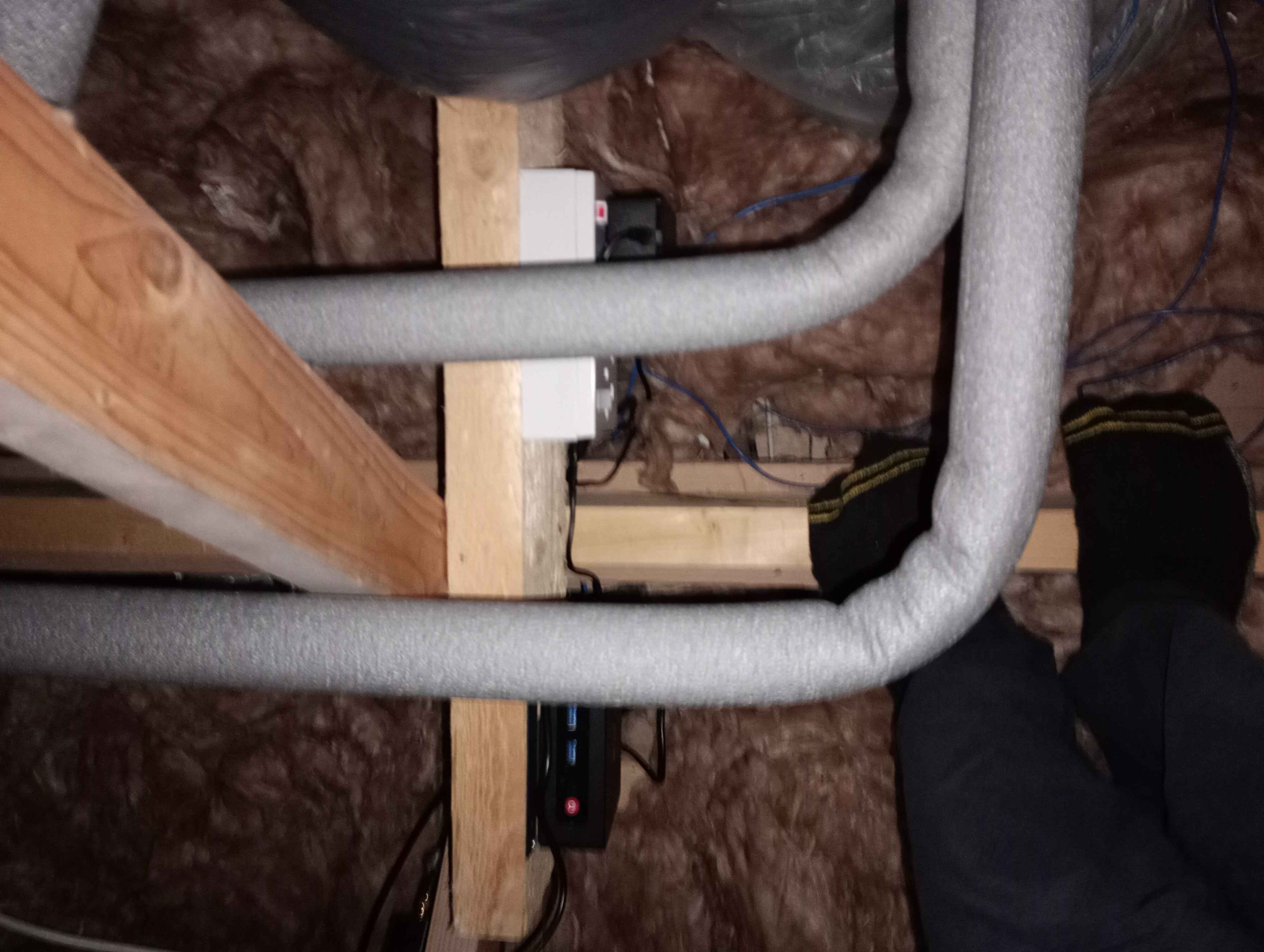

the raspberry boards are running of a tplink 5 port poe switch and also a decent cheap tenda unmanaged poe powered poe switch as I ended up needing an extra line and didn't feel like running it again lol
the pc does acars (currently feed Airframes - https://airframes.io with acars over iridium data from satellites in the sky)
It has a airspy r2 cable tied to the rafter beside it with a clip to secure the cables in place
the other stuff has a pi that does ads-b data (currently feeds a good few sites though my personal favorite is AIRPLANES.LIVE - independent unfiltered ADS-B and MLAT aircraft tracking. Learn about ADSB aircraft tracking and join the community. - https://airplanes.live )
the green sdr is acars also just it's the more old fashioned stuff and uses a antenna mounted just behind it
the grey antenna is a 1090 mhz antenna for the blue sdr and ads-b
the larger one in the back is a acars antenna from vinnant.sk (the of126s model iirc)
then the rest of the wiring is just either power or data lines and yes I know it's a bit of a cleanup (the box in the first image is removed in the past few days as I found the pi and sdr in it was getting too hot really

They all do different stuff
the pc runs the acars over iridium stuff with the airspy r2 sdr and a hc610 -28 antenna outside pretty much in the gutter
One of the pi board runs ads-b and the other does acars (the older one)
the sdrs are just mounted in a 3d print on the rafter to try and get them from being just sat in the insulation
eventually I have a plan to redo the cabling with some better kmr240 or lmr one day but for now rg58 works
the hc610 run has kmr240 though as it's a several meter run at least iirc
