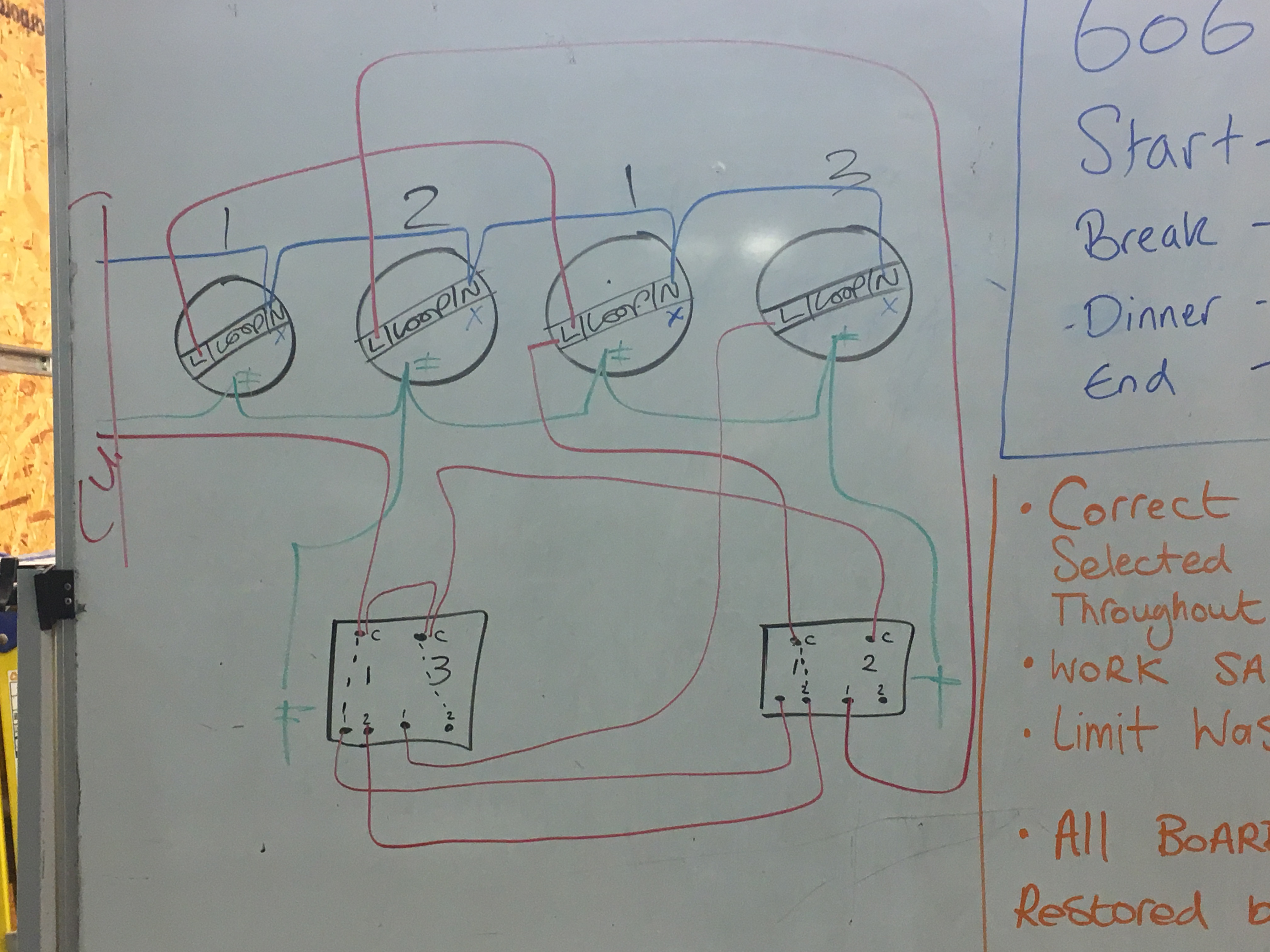

Hey guys would love your opinion on this one.
Last night I started a City & Guilds level 1 diploma in Electrical Installations at my local college.
Upon arriving at the lesson at 6 o'clock the tutor took the register and then put up a diagram on the board of two switches controlling 4 fluorescent bulbs and then said "right guys I want you to follow this diagram, draw it up and then create it yourself on this board (plywood) using the wires, switch plates and bulbs provided, you have 1 hour 30 to finish it"
On the diagram it showed common, L1, L2, Neutral and Earth which of course is normal however I was a little confused as I thought with this course being the level 1 the whole theory side of it would be explained first, for example this is the beginner course yet everyone was expected to know the wiring colours already and what L1, L2, common etc is?
I feel a bit thick after this first session! :tearsofjoy:, I mean I have done general tasks for my dads firm such as dragging cables under floorboards, puting on sockets etc but never actually anything like this.
I did speak to my dad about it after the lesson and he was very confused as to why everyone was thrown into the deep end straight away and why the theory of it all wasn't covered first. All I can think is that because a lot of the guys on the course are already electricians mates etc the tutor thought he would start us off with more advanced stuff?
I have a picture of the drawn diagram but I'm unsure how to post it up.
Anyhow let me know if I'm just being stupid and that it is normal to just jump straight into wiring stuff without actually knowing what all the wires are and why the go where :laughing:

if you consider a switch ( lighting for example) there are basiacally 2 types. 1 way and 2 way.
the 1 way is simple. Lin to Common, Lout from L1 (but there will be a L2 hole with no terminal in it)
a 2 way switch is also Lin to Common, and it toggles from C to L1 or L2.
just to confuse, some manufacturers will use different labels. i.e. L1 instead if C, and L2 and L3 for L1 and L2 respectively.

looking at your diagram, you have 2 x 2 gang switches. each has a 1 way and a 2 way to control the lights as per the connection of the reds. break it down. do each 1 way first, then consider the 2 way. L is going into sw 1 then will connect to sw 2 via 1 of the 2 strappers. dependent on which way each switch is switched, the light/s will be on or off. trace it through.

L1,L2.N & E? Do you mean L SL N & E Which college Barry? if you are concerned you ought to contact the College authorities.
Thanks mate that makes sense, I may try to recreate this at home and practice. On a bit of plywood of course :tearsofjoy:
