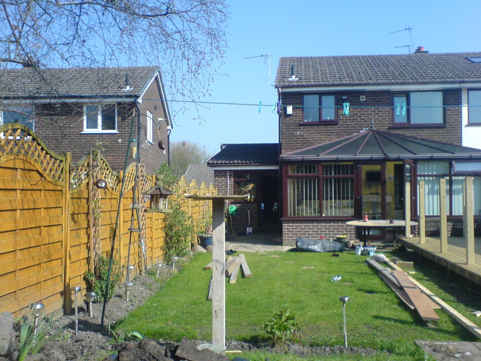

I would be grateful if someone could give me some pointers on decking lighting

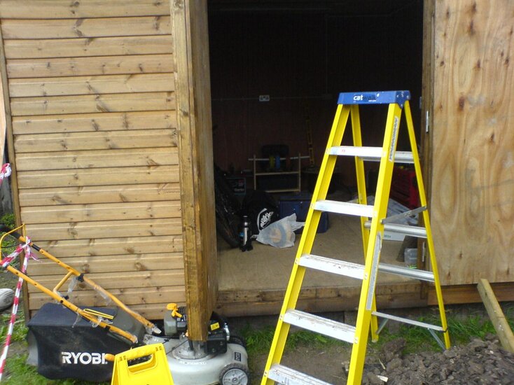

My Brother has had a large shed /workshop built
I have dug a trench 600mm to the shedabout 34m approx and installed 6mm 3 core swa in ducting to supply 4 metalclad double sockets using singles in conduit and 2 vapourproof fittings again in 1.5mm singles in conduit and a outside bulkhead over the door
i worked the volt drop out of the swa and its 5.2v this is using 21A as load for 20A for socket circuit 20Acb and 1 amp for the lighting protected by 6a CB
the length of runs for the sockets and lighting is approx 10m
the volt drop on the sockets is approx 3.6v so added to the swa volt drop gives 8.8v
the volt drop on the lighting is 1.2 rounded up so 6.4v just under the 6.9v max
I wanted to use 10 mm swa for the volt drop reasons above and also in case my brother wanted to add which he has now decided to do

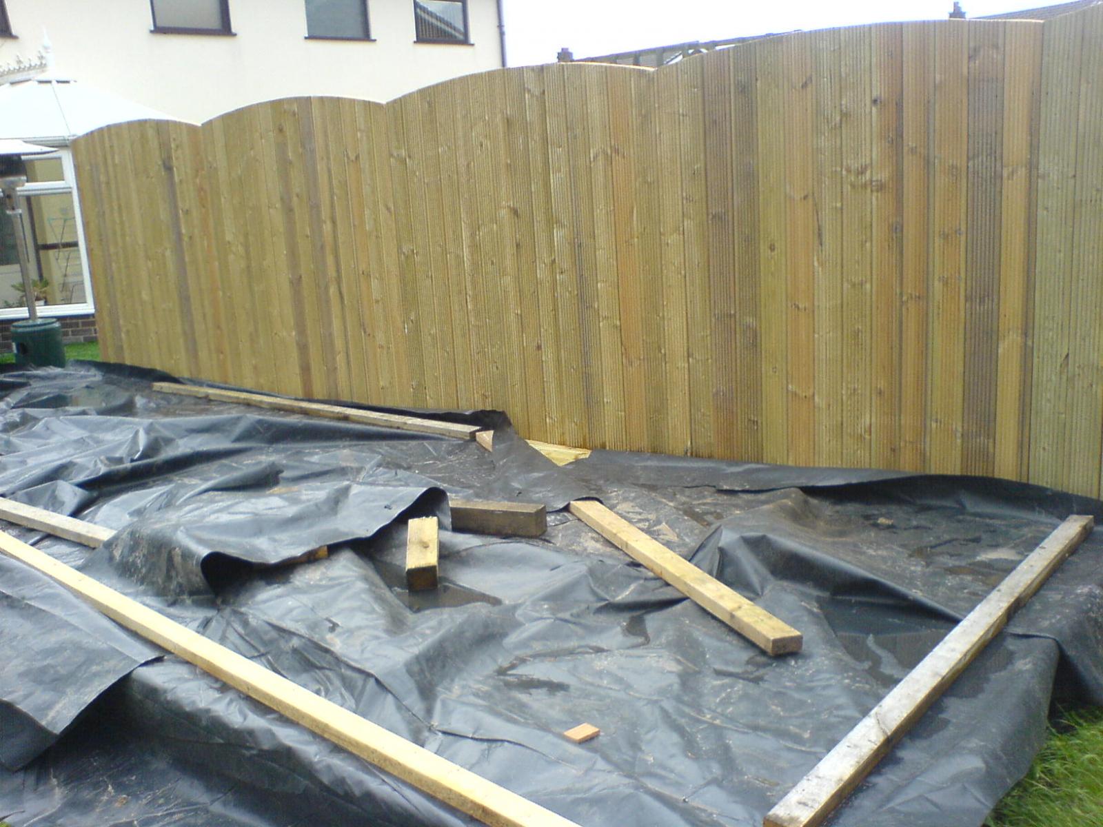

He now wants me to wire a outside socket of the radial sockets so means altering the conduit and the singles i already installed and also on the outside a fcu to supply a large decking area with decking spotlightsappox 20 of them and also 4 which will be on a vertical wooden wall at the back of the decking
the house is a TN-C-S system and needs a lot of improvment to the existing wiring and CCUs
Now I know i shouldnt have let him talk me into getting jsut a 6mm lol even though we got 33 metres for £80 and the 10mm was more like double
can someone give me advice on best types of lighting to use ELV with transformers thinking 12v and places to buy etc
will the Volt drop be an issue if supplied from the shed either by another seperate SWA to the decking or swa from a external FCU or should i directly supply the decking lights from the house using either another seperate swa or from the conservatory were there is double sockets but these are already spurred of the House ring with a 13 a fcu in the lounge
Sorry its not more detailed but this is a first for me installing decking lighting lol it wasnt invented when i started lol
any help and advice appreciated greatly

I think the volt drop would be fine for lighting 11.5v have you worked it out from origin? I think supplying from shed would be ok. What was the Zs from the shed did you not think about exporting the earth?

I have calculated the volt drop from the origin to the shed ccu and then added the Vd of each circuit in the shed in turn the swa calculated volt drop is 5.2v
the Zs from the shed i havnt measured yet as the swa isnt connected yet only ran it in thursday after digging for 3 days lol
jsut trying to weigh up wether to supply the decking lights from house or the new shed ccu
the Ze at origin is 0.09ohms and the swa calculated R1 +R2 is 0.21 the measured R1+R2 of the lighting final circuit was 0.27 so 0.09+0.21+0.27= 0.57
and the sockets R1+R2 will be around 0.27 also taking into account 1.2 correction factor for increase in resistance due to operating temp so again 0.57 this will be including the alteration to take into account the extra few metres for the outside socket he now wants
then either i culd install a waterproff FCU at side of it and run a 2.5mm or 1.5mm swa to the decking
Or just take it direct from the spare way in the CCU in the shed
or run another seperate swa direct from 1 of the spare ways in the house
there are no extraneous conductive parts in the shed all wood no other services or metal steelwork and i have run a 3 core so the 6mm earthing will suffice and then earth the armour at one end also so no need for a seperate earthing rod for the shed jsut use the 6mm 3rd core as my CPC back to the MET in the house
just need some ideas for the types of lighting that would suit best a fellow forum member says transformer with 12v output

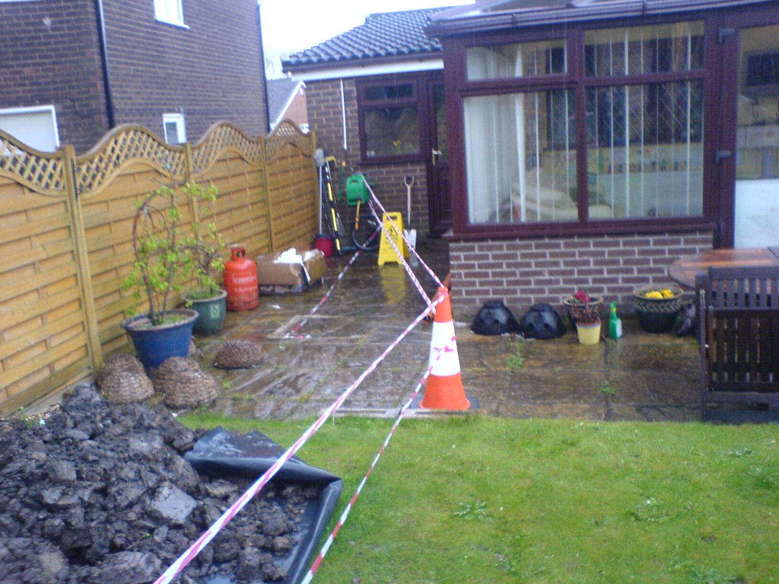

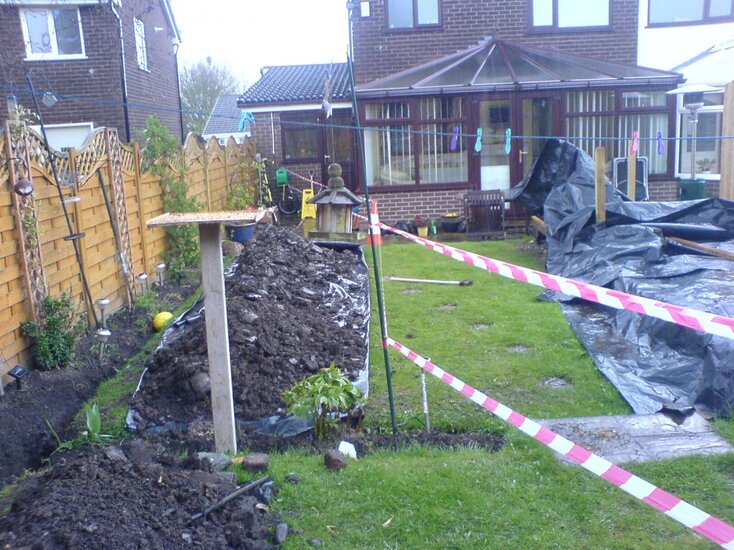

I have done the first trench laid the ducting installed the swa and have dug the second trench from shed to decking today
600mm deep
My brother i think wants the small LED 12v 2 sets of 10 so jsut looking around for some reasonably priced but good quality sets
He is still undecided on the 4 lights he wants on the rear wall which is basically vertical decking
