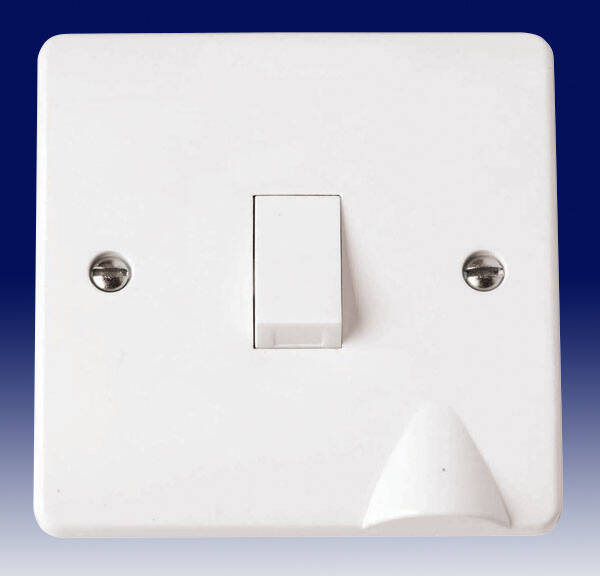

20A switched cord outlet below:
[ElectriciansForums.net] Definition of own circuit
