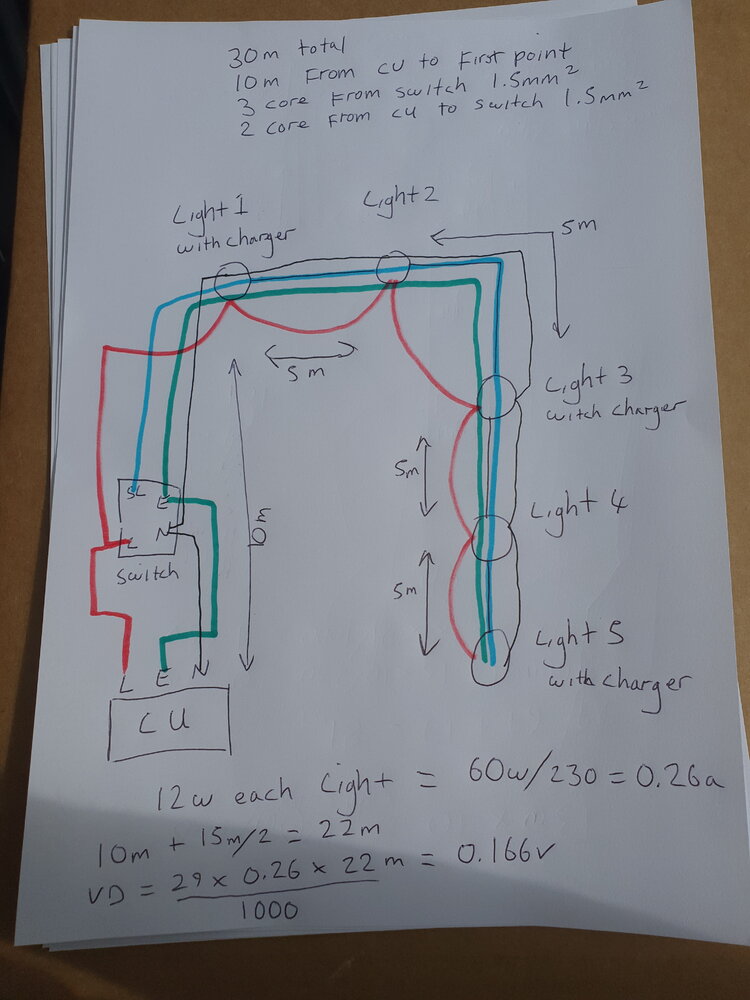

it's more complex that a simple calc. say you have 10 lights. you calculate the VD to the 1st light, using the flc.and the length to the 1st light, then from 1st to 2nd using 90% FLC. then from 2nd to 3rd using 80% FLC.............. from 9th to 10th, current is ony 10%. i.e. the current draw of 1 light.
So if i had 12 led lights on 1.5mm twin and earth one circuit of 24w each and the circuit was say 90 meters and each light was evenly spaced at 7.5 meters
so the VD would be something like this at each point of the circuit?
1 24w/230 = 0.1a (29 x 0.1x7.5)/1000 = 0.02v

your first light feed will draw the full current of all lights. the second feed will draw less (11/12 of total.) then 3rd will be 10/12 of total. etc., etc. so when you get to the last light, that will be your total VD.
so was what I did right just 12 needs to be 1?

so the total would be the sum of all of the above voltages?
Yes. It should be close to total current and half the cable length of drop, but depending on how your rounded the numbers it might to add up that way.
Normally you only do the full calculation for VD if it is not a uniform distribution of loads, or they are of quite different values. And even then only if you have reason to think it is going to exceed the 3% limit. The OSG table of standard circuits / lengths saves time!
As mentioned above, there is sometimes a longish 'home run' between the DB and the first point, which obviously carries the full current and incurs the highest drop per metre of any section. Therefore I would always take the effective length of the circuit as the length of the home run, plus half the remainder, then calculate the drop using the total load.
In your example that's:
7.5m [home run] + 82.5/2 [half the remainder] = 48.75m effective circuit length for VD purposes.
Total current = 12 x 24/230 = 1.252A
Drop for 1.5mm² = 29mV/A/m
Drop at furthest point = 1.252 x 29 x 48.75 / 1000 = 1.77V
Your calculation adding the drops length by length will give the same result if you redo it without the rounding errors!
