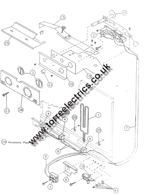

does any one know where the thermal cut out is on a dimplex xt12 and how the front cover comes off
cheers
Check out this picture
[ElectriciansForums.net] dimplex xt12 thermal cut out
Im not sure if its the same one as what you have, hope it helps.
That site also sells the parts as well.
Just realized its the same one as I have right next to me, screws are on the back - take it off the wall.
Open it up and trace the mains cable in, the thermal cutout will be on the main cable between the mains inlet and the control board.
