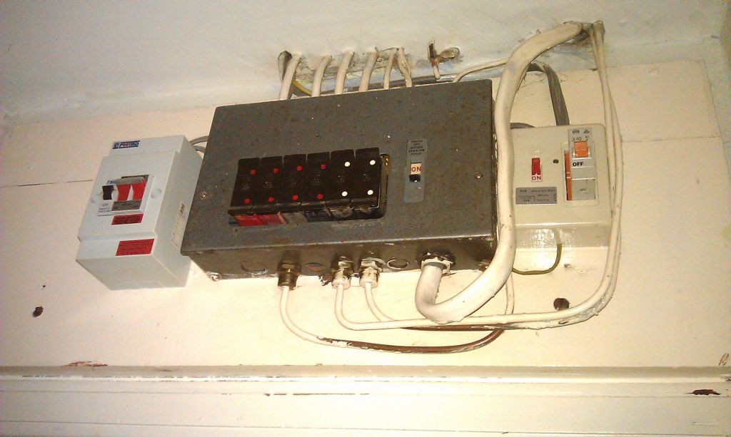

Customer also asked for a quote to update the fusebox and relocate it from the top of the landing to the ground floor beside the meter.
The photo is what I'm up against....the whole house (apart from a few additions in the last 20 years and the supply from the switchfuse - massive old mem asbestos filled job) is done in pyro..
Plan being - Remove the old metal clad wylex board and the 2 mini boards, install a DIN box, extend the cables in T+E, drop down in maxi trunking, along the top of the ground floor ceiling (pretty hidden from view anyway) and down into the new CU. Switchfuse to be correctly disposed of, isolator fitted on the tails and new CU installed. All cleared with the customer (for once someone who doesn't do their nut over the suggestion of trunking...)
So I'm wondering if anyone can recommend a suitable metalclad DIN enclosure to allow me to secure the MICC. I've attached a photo for your perusal (going all posh now seemingly )
