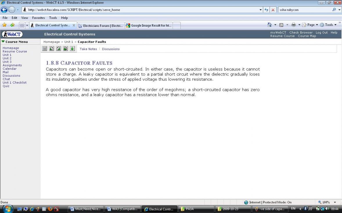

Want to do check to see if they're still working. According to my course notes "
A good capacitor has very high resistance of the order of megohms; a short-circuited capacitor has zero ohms resistance, and a leaky capacitor has a resistance lower than normal."
Here's the deal.
1. Connected +ve DMM probe to +ve wire on capacitor and -ve DMM probe to -ve capacitor wire and got a reading of one. DMM was set to 200K.
2. Switched around leads on DMM, +ve to -ve and vica versa, and I got a -ve reading of thirty which quickly went to zero and then started to increase to 100.
Took the probes away in case it exploded. What was happening here exactly?

A capicator is like an open circuit, but even free air has a limited resistance. plus with emf etc you will get leakage, so in theory yes, you should have a high resistance if there is no breakdown in the cap.
When you measure the resistance of a cap the DMM will uses ohms law to calculate, so will give out a voltage at a given current. But as the caps store charge the resistance will change which is what you are seeing.
You want a scope so you can see the charge and discharge
