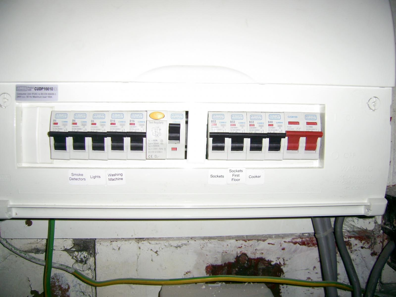

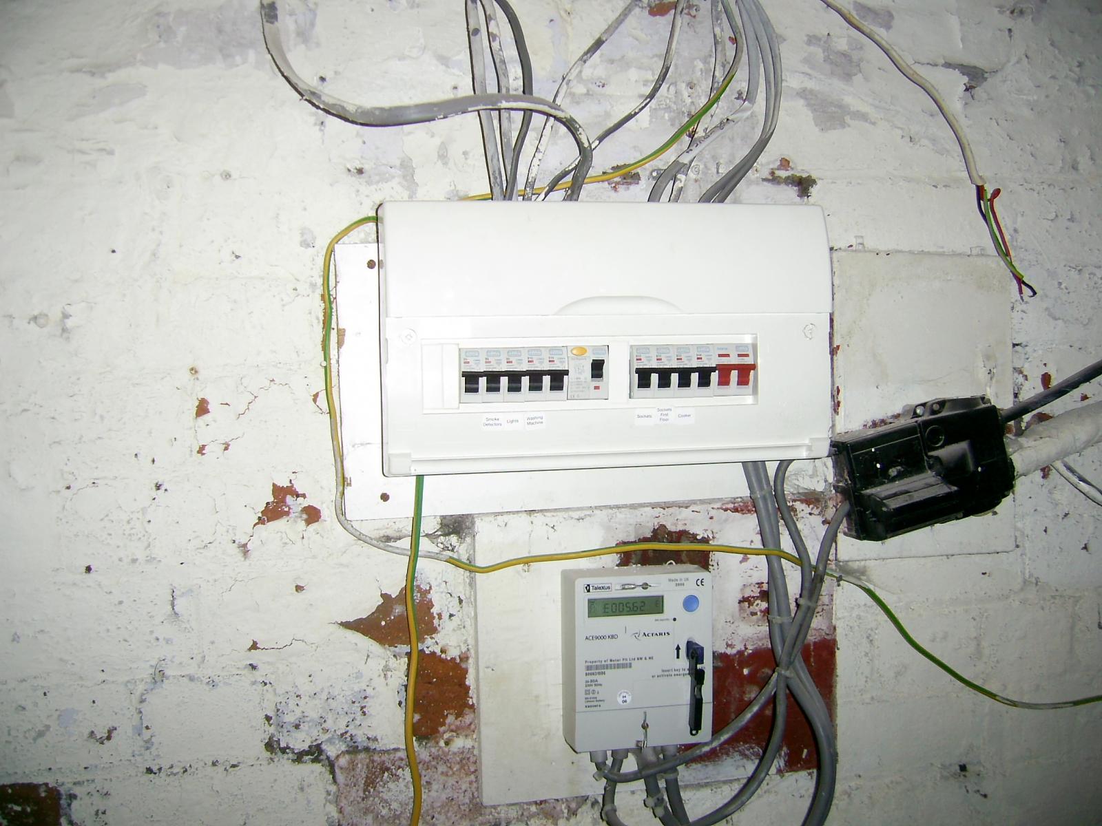

found this today on a pre sort-out inspection:
[ElectriciansForums.net] disconnection times?
all appears fine apart from the downstairs sockets not on the RCD side...split load board to the 16th ed
now lets pan down a bit:

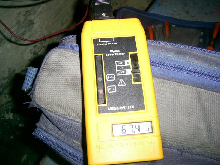

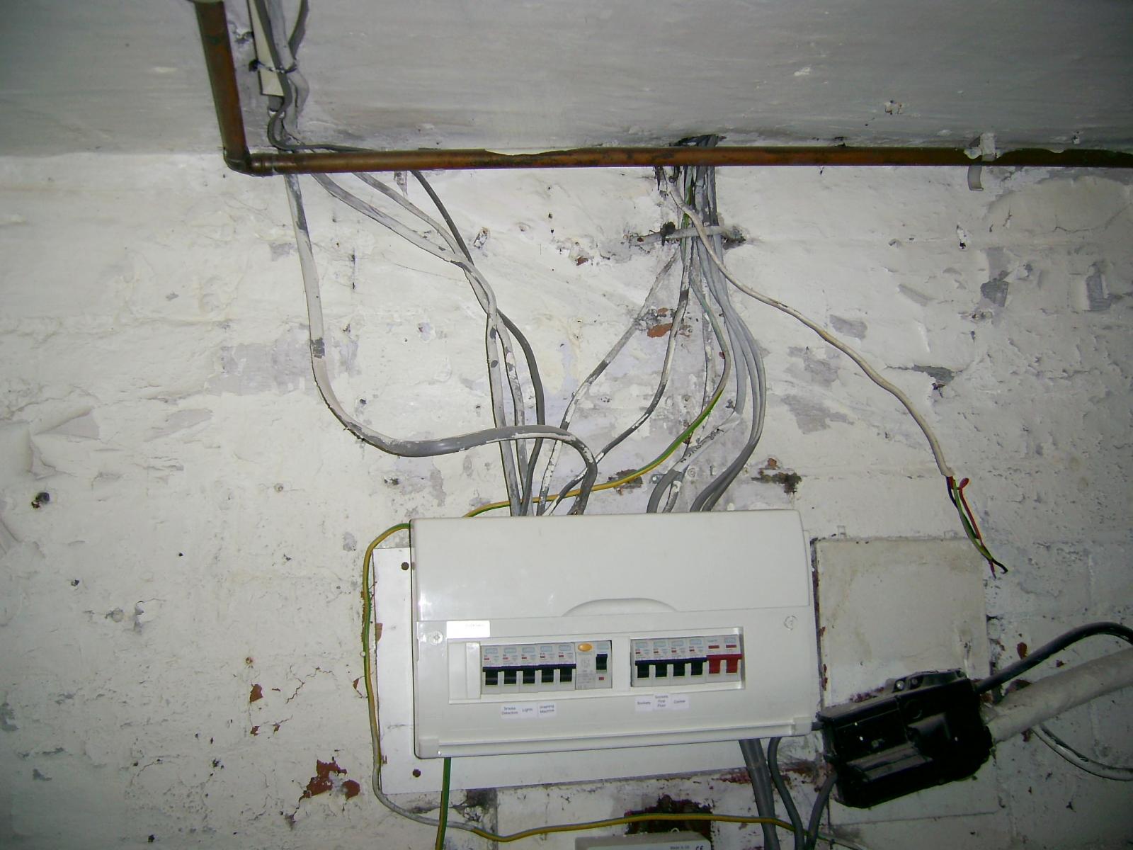

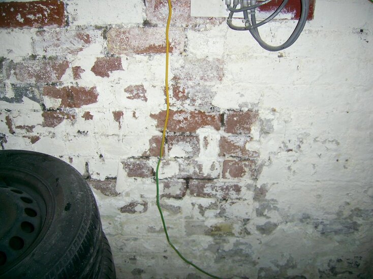

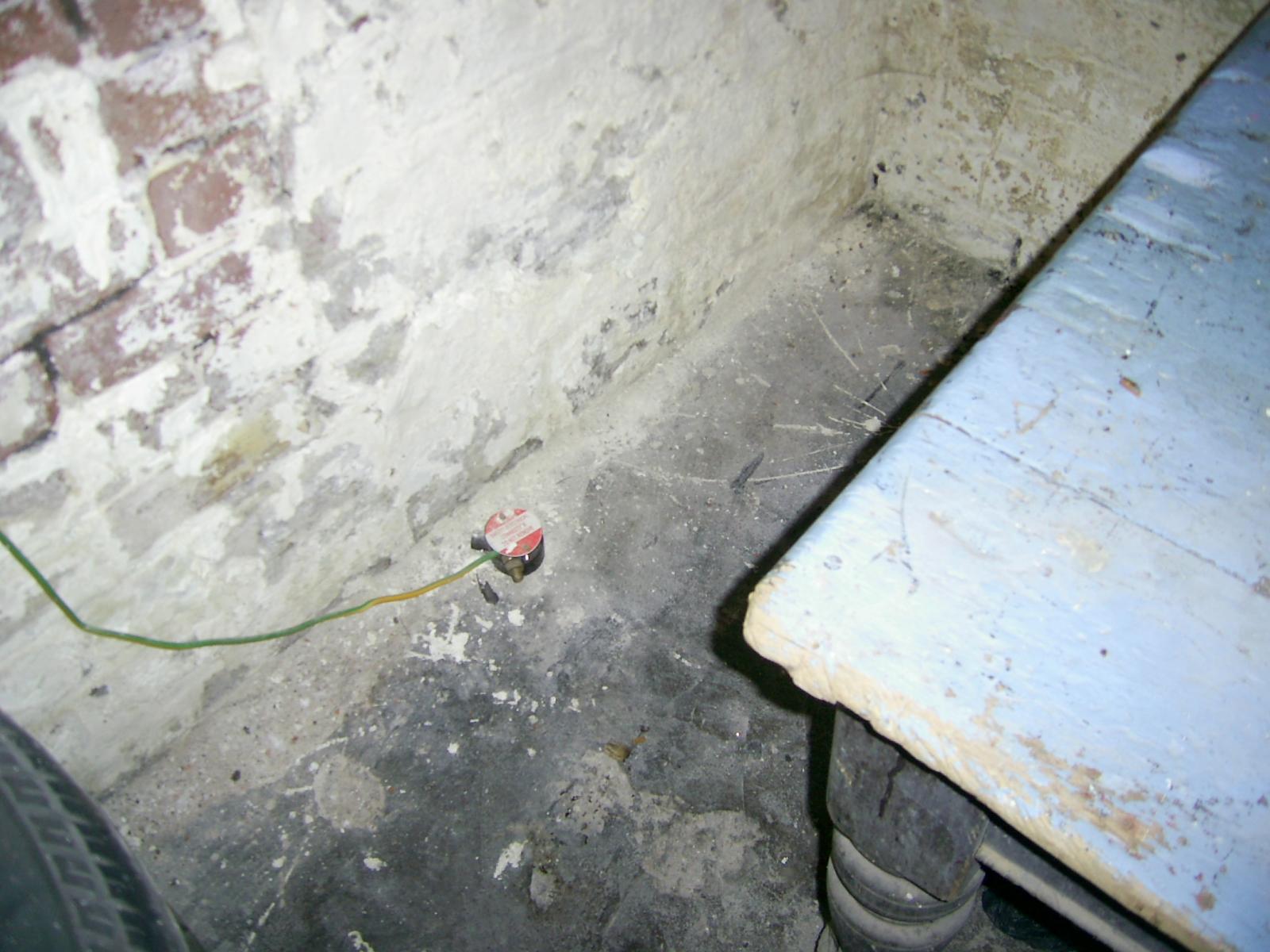

yep...its TT...heres some more:
i wasn`t too impressed with the workmanship here either:

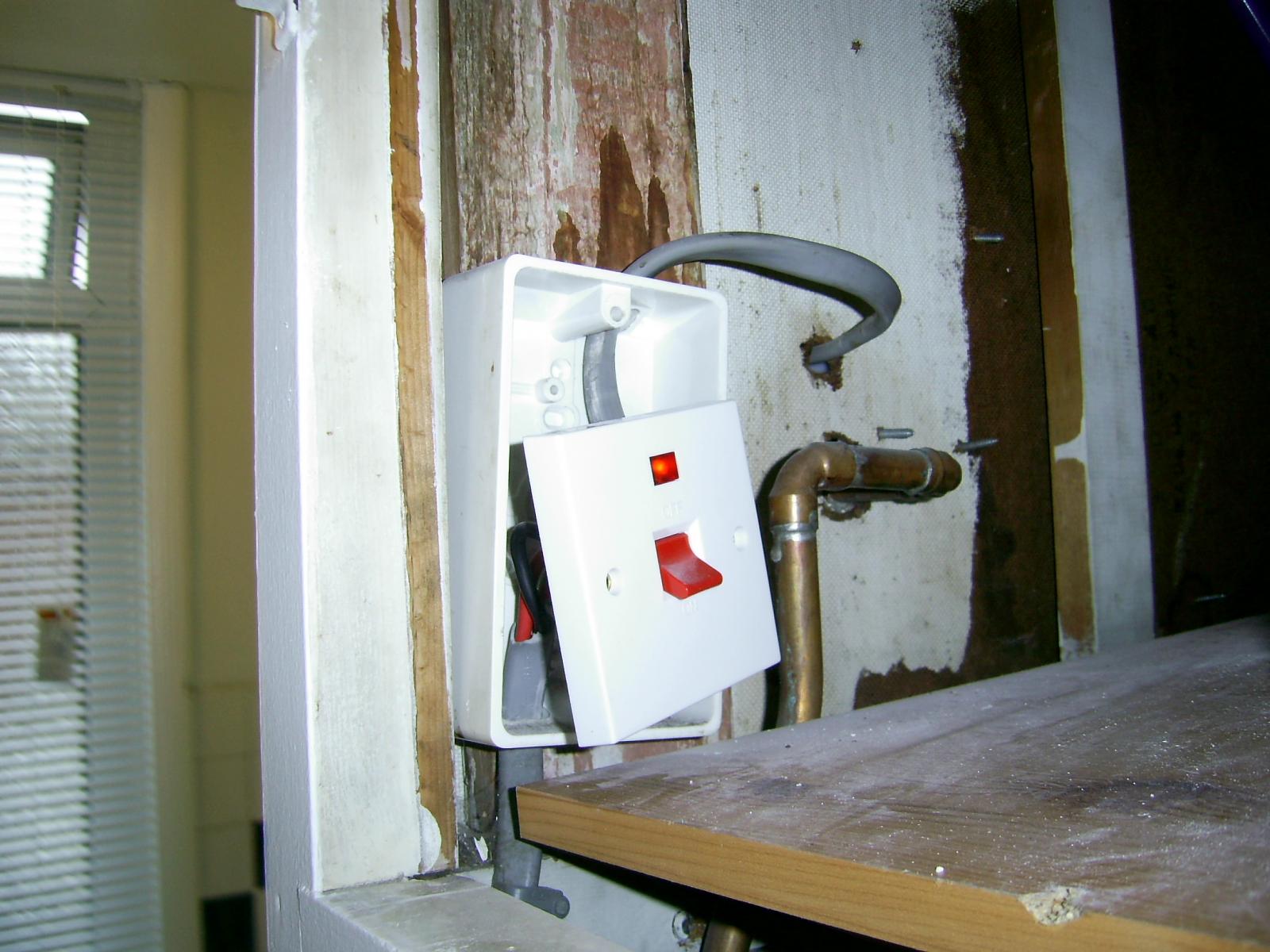

went into the bathroom..and found this:
oh, by the way...the DP switch in the pic is wired with the incoming on the outgoing...as the neon wont go off when the switch is opened.
and here`s a bit more from the bathroom:
i dont like the FCU and fanswitch where they are as its right next to the bath and the showerhead is a handheld one....

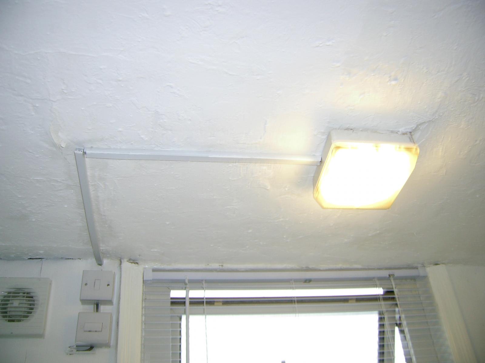

check out someones idea of a trunking job as well....lol...
Hi Glenn, where is that install, it looks very familiar, i am sure i have been introduced to it at some time a while ago, i seem to remember putting a quote in, and advising PME connection from DNO. I then heard nowt.
well..
were going to drop another RCD in there for the unprotected ways...and sort out the bathroom crap as well Howard...
i will straighten out them cables thats coming down as well....
it`ll be a shared suppy tel...
the paper-lead comes in here as can be seen...then splits out from the head to another service head next door...
i`v worked on loads of installs set up like this...
usually on the other side...lol..
both service heads will have 60A BS1361 type IIb`s in em...
