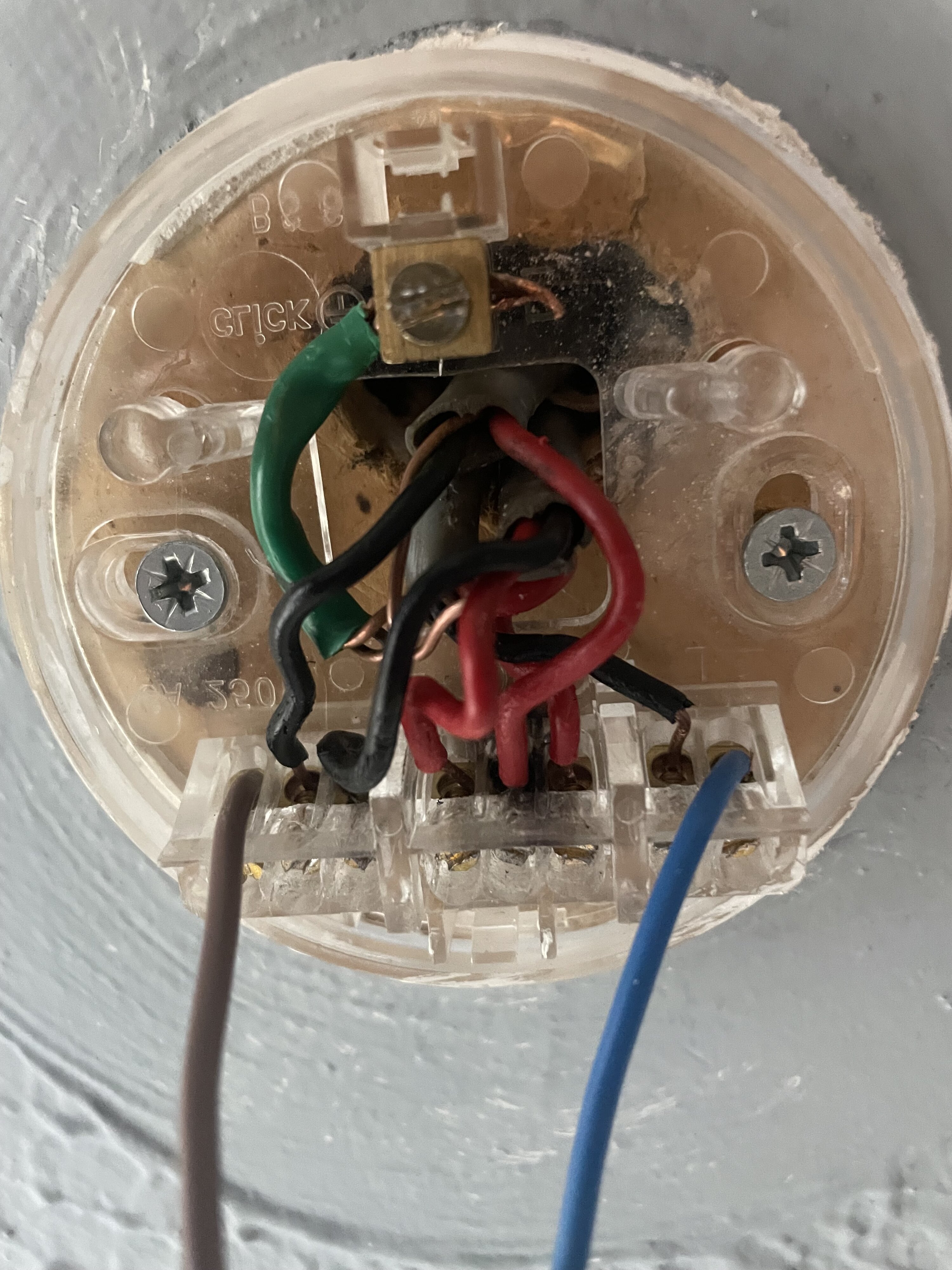

Looking for advice on how to re-connect a ceiling rose loop connector.
I am trying to achieve room 1 and room 2 lights to be independently on and off. This previously worked until i decided to try and change the fitting without taking a photo of the wires as they were when working. Yes i know, school boy error.
The ceiling rose is in room 1, room 1 has a 1 light and 1 switch.
In the ceiling rose it has 3 feeds into it, all 3 have Live Neutral Earth.
The house uses old red, black and green/yellow wires.
None are identifiable as main feed or switch feed. All look same (no sleeve on switch input).
Room 1 ceiling rose feeds to room 2, room 2 has 1 light and 1 switch.
I have found many diagrams online but am struggling as i can't identify which cable is which (main or switch etc). I currently have room working correctly but room light permanently on!
Attached is a diagram i am thinking of following

Do not follow the top picture that will create a dead short. Might be optimistic we can advise from here as you need to establish the cable to the switch, can you show some pics of the actual wiring?

Currently room 1 light is permanently on and room 2 is not working, although it has been earlier on today, so not sure why it’s not now as I hadn’t changed anything since my first message.

Which room is that from?
It is going to be impossible to tell you how to connect them unless the switch cable can be established.
I thought as much. How would you go about identifying the switch cable.
And could offer a guide to wiring based on the info if we knew which wire was which?
Appreciate the time and effort, thanks
Do you have any testers there? A simple multimeter is sufficient to find the switch.
I’d advise not to reenergise the circuit at the moment.
All that is wrong (apart from your blue and brown flex being the wrong way around) is that the single black should be in the terminal where the two blacks are now, and one of those blacks should be where the single black is. The problem is determining which.
Get it wrong, and there will be a big bang, a damaged switch and a damaged MCB.
A way you can check is to swap one over, ensure the switch is OFF, turn the power on and check if the lights further down the chain from this one work as normal. If they do, you've probably got it right. If they don't, switch off the power, try the other black as the single and check that the other lights work.
I can soon get one, how exactly do I identify the switch…I’m assuming it’s the one without power in it 🙈
Power off !
The switch wires will be the ones that go low resistance when the switch is turned on and go open circuit when its off.
