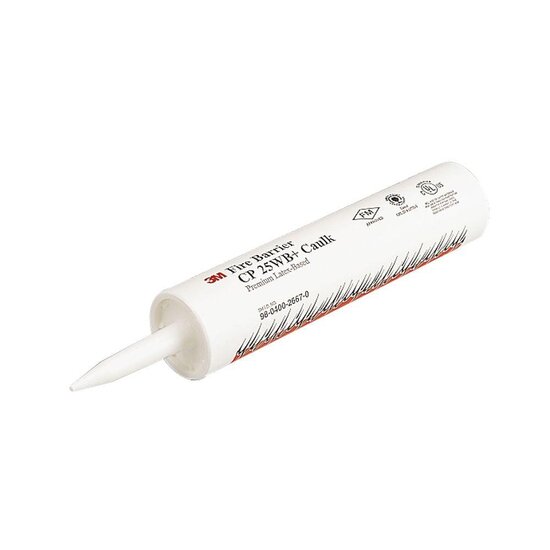

after you get the conduit through pump some fire sealant or a silicone based caulk around the conduit both insideof the wall and outside before you put your box up
We are required to use fire sealant when going through walls (commercial and industrial)
heres what we use [ElectriciansForums.net] DIY Question & Where Can I Get......
Im sure you have something similar in the UK.
We have the same regs on every type of building structure but in this case there is no need for a fire ratted barrier. This is a domestic house with only one residence, its too small of a hole to require a fire ratted sealant by our regs (i believe) and its a hole going to the exterior of the building.
A very good point though :smile: For the price of ÂŁ6 ($10 ish) but mainly used for interior use to hold back the spread of fire for a certain amount of time according to the regs and uses for that particular building.
