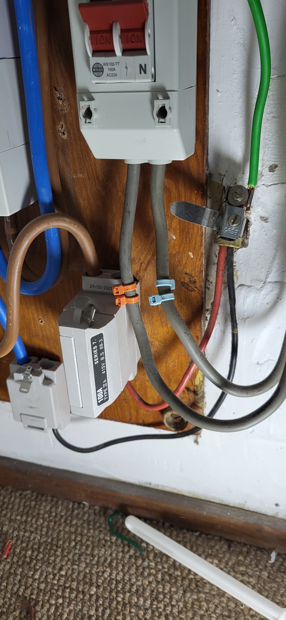

I've come across this incomer, looks like 10mm conductors.
The dno has upgraded the meter and used a 100A fuse.
So my question is, does this need reported or can I do whatever work I please along as I don't overload the 100A fuse 🤔

What type of cable is that? Is it singles in conduit or is it MICC? With a clamp on pot for the earth? If it's MI, it might be large enough, partly because the solid conductor is larger than it looks, and partly because of its high current rating for a given size.
I wondered if it was MICC. Would it be possible for them to be double insulated (as they stand) if it was?
Yes looking at it again I see the female bush now. 7/.052 looks about right, just under 10 sqmm. Anybody spot the strands of earth that didn't make it into the clamp terminal?
It's a BS951 pipe clamp on a conduit, that obviously isn't the service cable itself but extends from either a multi-service cutout or looping point or something elsewhere.
When I first looked at it on a phone screen it looked like the end of a pot poking out but it's a female bush. Sometimes MI is used in this application between the point of entry and the meter position. Often with the pot and stub sleeves exposed; not correct practice but it is done.
