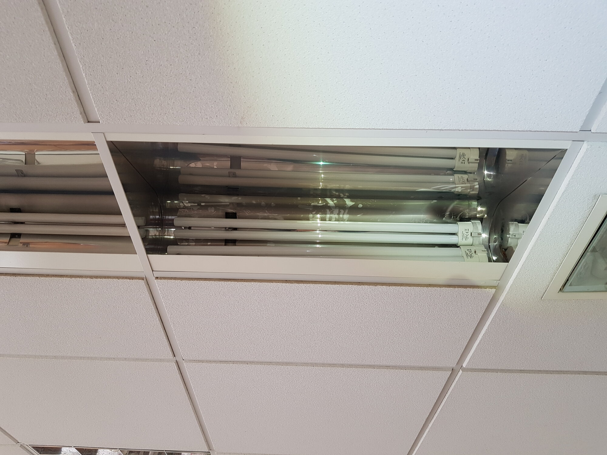

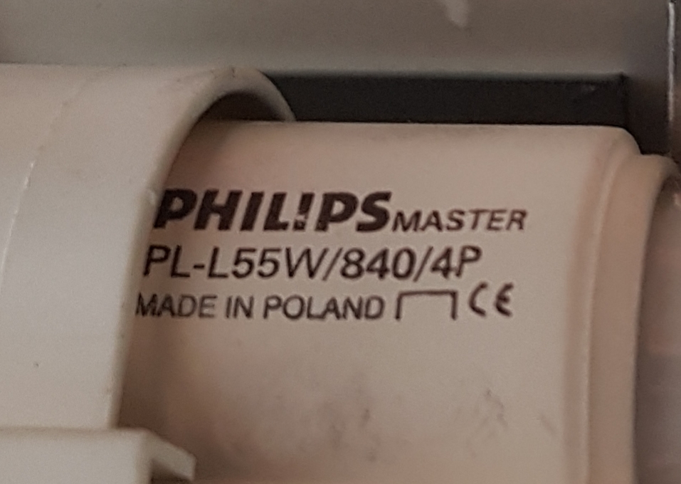

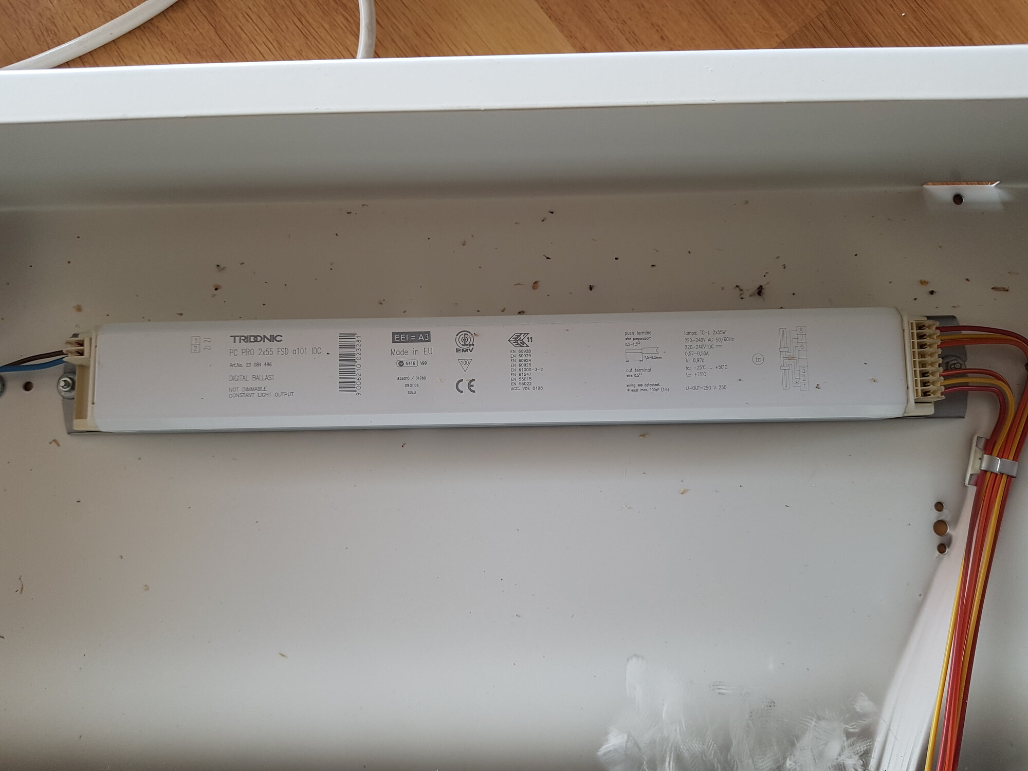

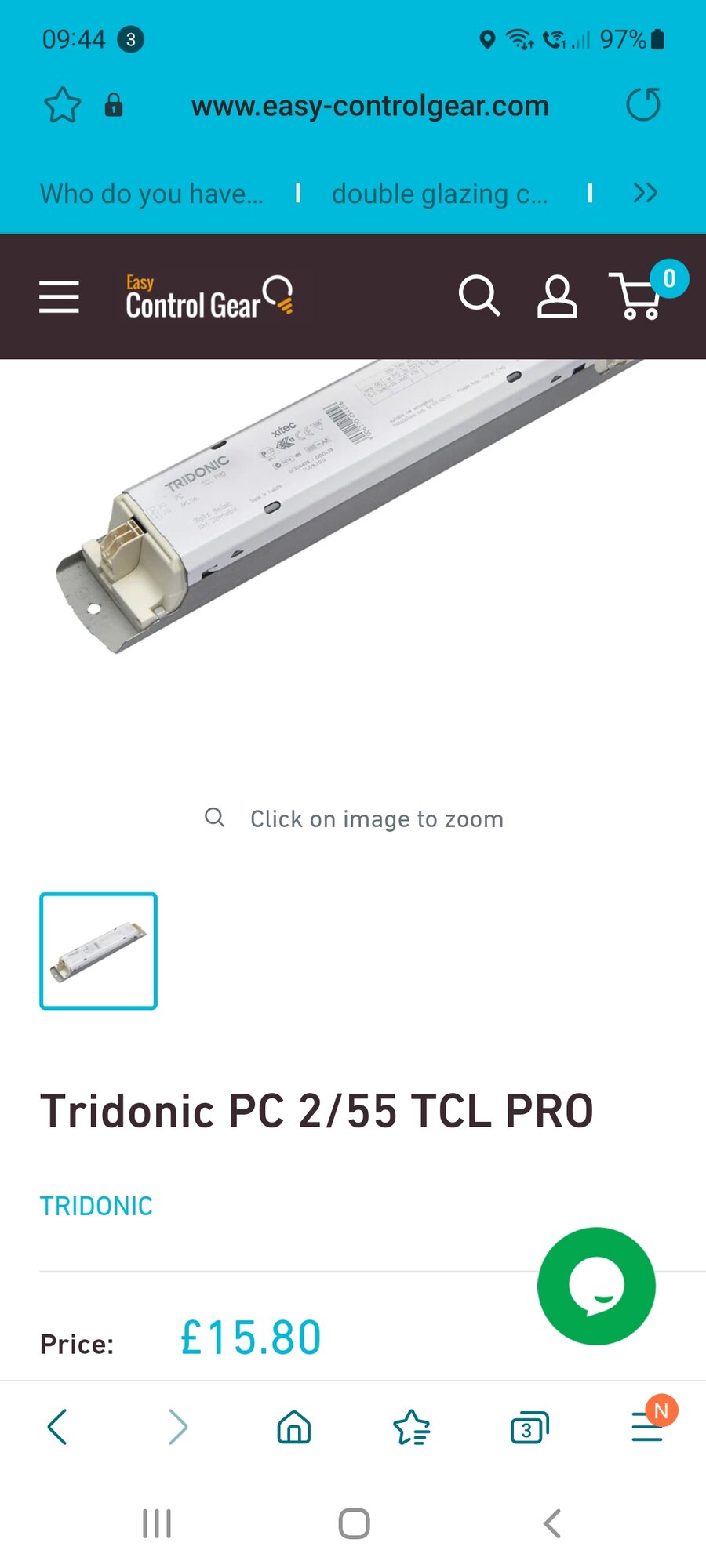

I have narrowed the fault down to the ballast in this fitting. See picture.
I cannot find an identical ballast. Blimey, there must be hundreds!
Is there a similar ballast I can use? Bearing in mind the existing cables, both supply and load, are terminated into little blocks that clip in either side of the ballast. Or, are there other options? I never work in commercial settings, hence having a limited knowledge. This is for a friend who runs a local charity shop, hence having a look. The word hence seems to be a common theme 😄, a bit like the word 'damn' during the early years of @davesparks threads 😉

Is that a fly killer? It might be easier and cheaper just to replace it.
That's kind of what I as thinking, but having not done this before I thought that may be a bit extravagant, also finding a fitting exactly the same size may be just as hard.

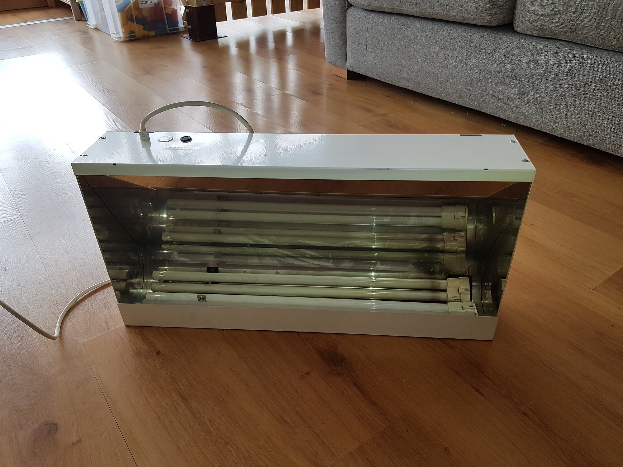

Here it is in situ. It's not a fly killer 🙂
[ElectriciansForums.net] Do I replace the ballast?

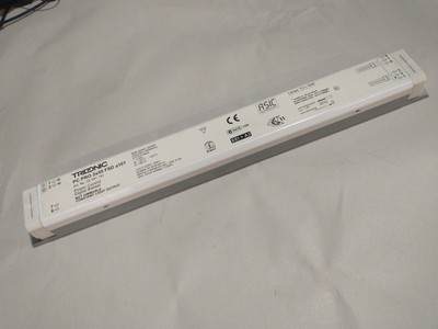

I'm a bit out of touch with wholesalers these days but that used to be the sort of thing you'd get on the shelf - a twin electronic ballast. The make doesn' really matter.
If it is as simple as replacing the panel, then I think I will do that. I'm guessing most panels are a generic size? It seems that an entire fitting is not very expensive.....

try here:
chrome-extension://efaidnbmnnnibpcajpcglclefindmkaj/https://www.tridonic.com/com/de/download/data_sheets/DS_PC_T8_TOP_18-58W_en.pdf
You could try eBay….
Cheap enough… but the time taken to swap it over might be more than changing the fitting.
Changing a ballast is much quicker, once you've done a few it's a doddle.
Just drop the old one down, fix the new one in its place and transfer the wires one at a time.

I assume this is a retail outlet and your duff fitting is what I call a wash light not a solid flat panel and they do LED versions.
Well sort of. It's main purpose is to allow single parents to meet up with their kids. It does sell cards to make a bit of cash.
Is there a proper name for the type of light I am looking for? It slots into the ceiling, being help up with an interlacing metal network. The ceiling is all the same, polystyrene type squares all slotted into the same metal framework.
I've been searching for 'recessed panel light', but perhaps their is a proper name for it.
