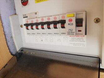

I may well need to change all the MCB's for RCBO's in this board (see picture).
Do Wylex RCBO's fit in this board? It is currently fitted with NSB MCB's.
Also, Wylex seem to do a few different RCBO's. Do they all fit, especially the new compact range?

No you would need the NSBS6-B/1 which are still available, you can’t mix match the NSB and NHX together on the same busbar, please note if the cat number of the consumer unit you have starts ‘NS’ and they are the very old style NSB MCB’s then the NSBS RCBO’s will not fit and there would be nothing now, if you have a unit where the cat no starts ‘NH’ then the NSBS6-B/1 will fit no problem.
The board above is an "NH". Most questions on this topic are about putting RCBO's in older NS boards.
I think the opposite to normal has already happened, someone has loaded up an NH board with NSB devices, as per Wylex's comment above.
(You can even still get a metal front for that NH board to turn it into an NM806)
I have an email from Wylex somewhere clarifying that the NSB and NHX on same busbar thing is entirely about a slight dimension difference causing the lid to sit wrong and otherwise they are fine together. In reality I remember not being able to reproduce this.
No they dont fit. I tried it. Stick a Fusebox CU in, will be much cheaper
Are you sure that was an NH board you tried it in? I have the exact opposite memory. I could be wrong though!

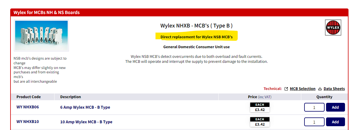

Also note that TLC say this:
[ElectriciansForums.net] Do Wylex RCBO's fit as a replacement for NSB MCB's?
In general my understanding is that NHX are compatible with older NSB devices.
This chart suggests that NHXS RCBO's would therefore also be compatible.

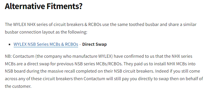

I also recently found this interesting snippet:
( WYLEX NHX Series MCB Technical Details - Free 2020 Guide - https://electrical-assistance.co.uk/wylex-nhx-mcb-sizes-specs/ )
Despite that chart which I have seen before, I have personally fitted dozens of boards in the mid 00's (so well before 2018) that had the 'cage' type busbar, I think , if memory serves, that they were special order populated boards for social housing projects.
There are definitely 2 types of RCBO available in the 'full height' format (confusingly iirc both with NHX part numbers. ) and only 1 fits the balcony busbars properly although the cover is then hard to fit as it is slightly mis aligned. The compact types definitely do not fit.

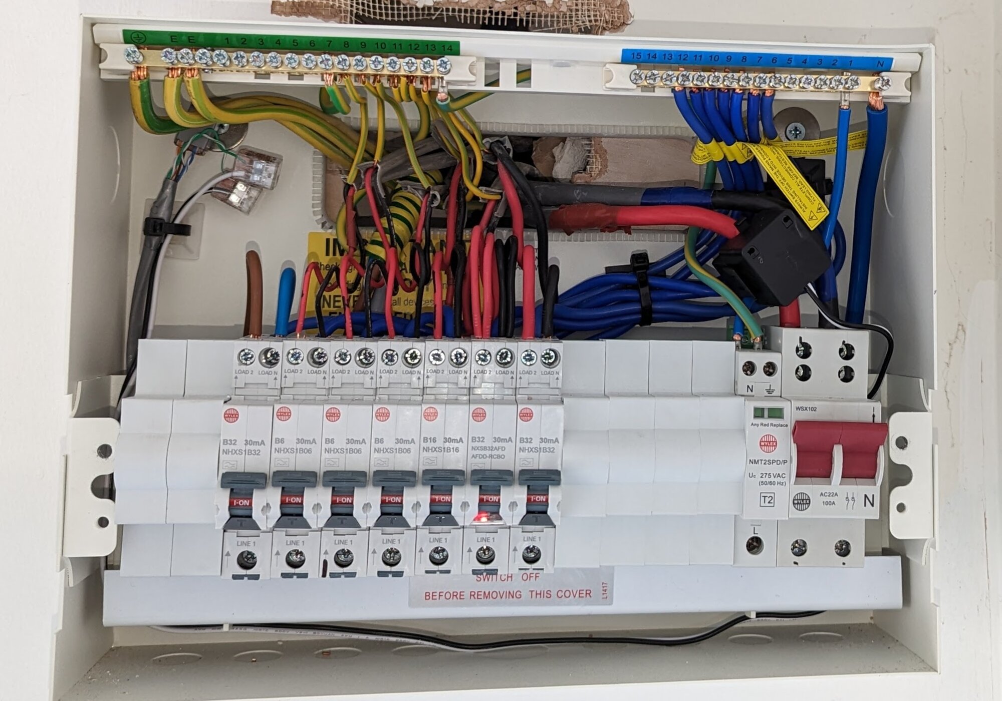

You should fit a new Wylex one, I fitted one yesterday for the first time, I was really impressed with it good quality metal and the main switch with double screws are rcbos are extremely solid
I like the quiet and subtle way you posted a picture containing a brand new AFDD without reference to it at all!
