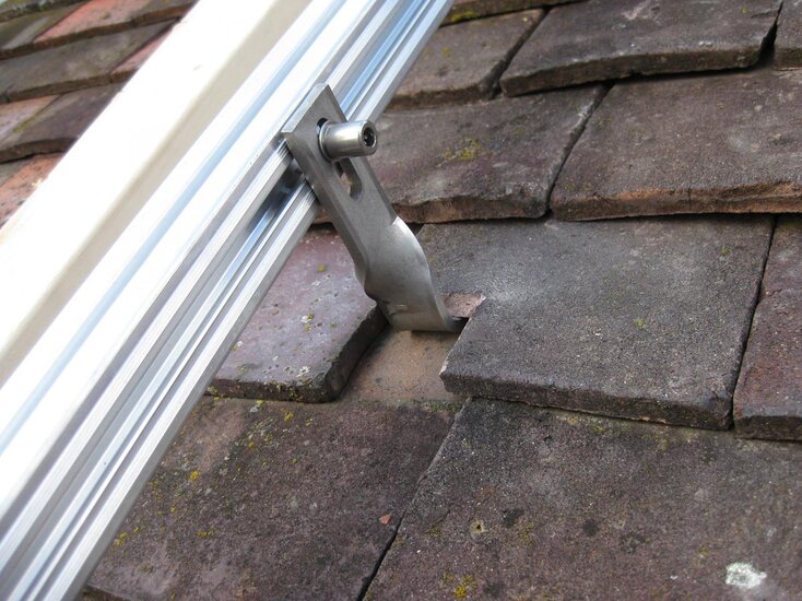

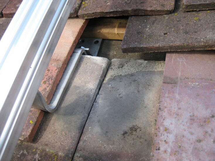

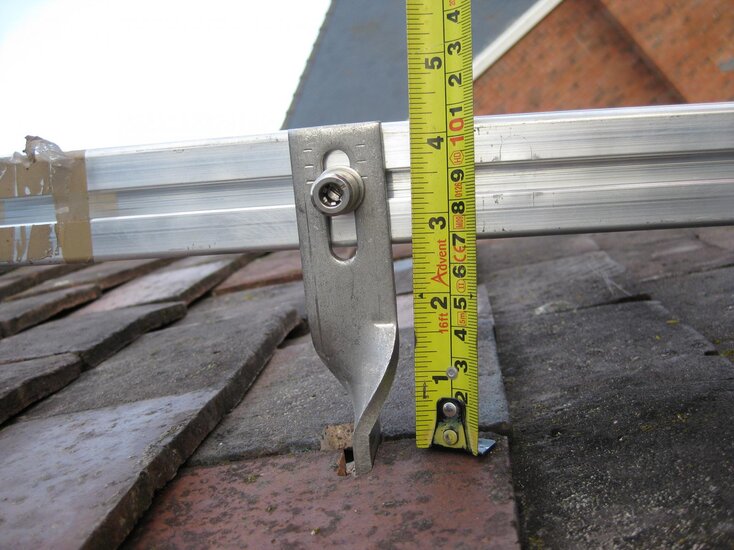

HI all,
doing first install,
we are just fitting the hangers today, my question is do you have to lead flash the roofer im working with says there is no need. i took some photos
[ElectriciansForums.net] do you have to lead flash[ElectriciansForums.net] do you have to lead flash[ElectriciansForums.net] do you have to lead flash
what you think
Cheers Grand
I do on Rosemary as a matter of course, some of the older clay tiles crack the moment you stare at them! You can bet a hairy one that once the rail is on and your lifting the panels up the little tile underneath the hook will crack and all you will hear is that anoying noise as the broken bit slips down the roof and you shout out loud F*&%^%%^ Hell!!
so whats the best thing to do, flash the tile thats under the bracket. i dont mind because i can see it will only take 5 mins, also roofer asked what gaugue i wanted as there was alot in the price, can you get the thinest??
cheers for reply
Grand
code 3 - Price per Kg, depends on supplier, i used 150mm wide. I flashed under and over on mine, but had different hooks to you.
Yup, code 3. Get loads of the stuff on rosemary installs. I would lead under and over also. The tiles need very little persuasion to fall to bits and judging by your installs there will be a fair bit of pressure on the tile just where you don't want it as soon as the winds gets up.
Neat looking install though.
