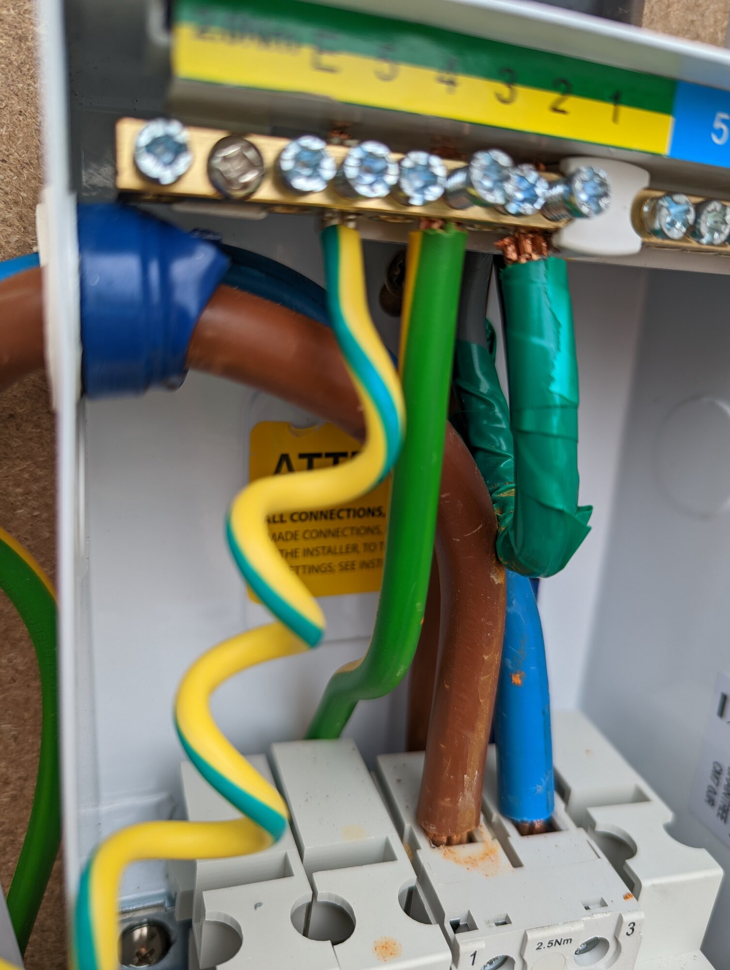

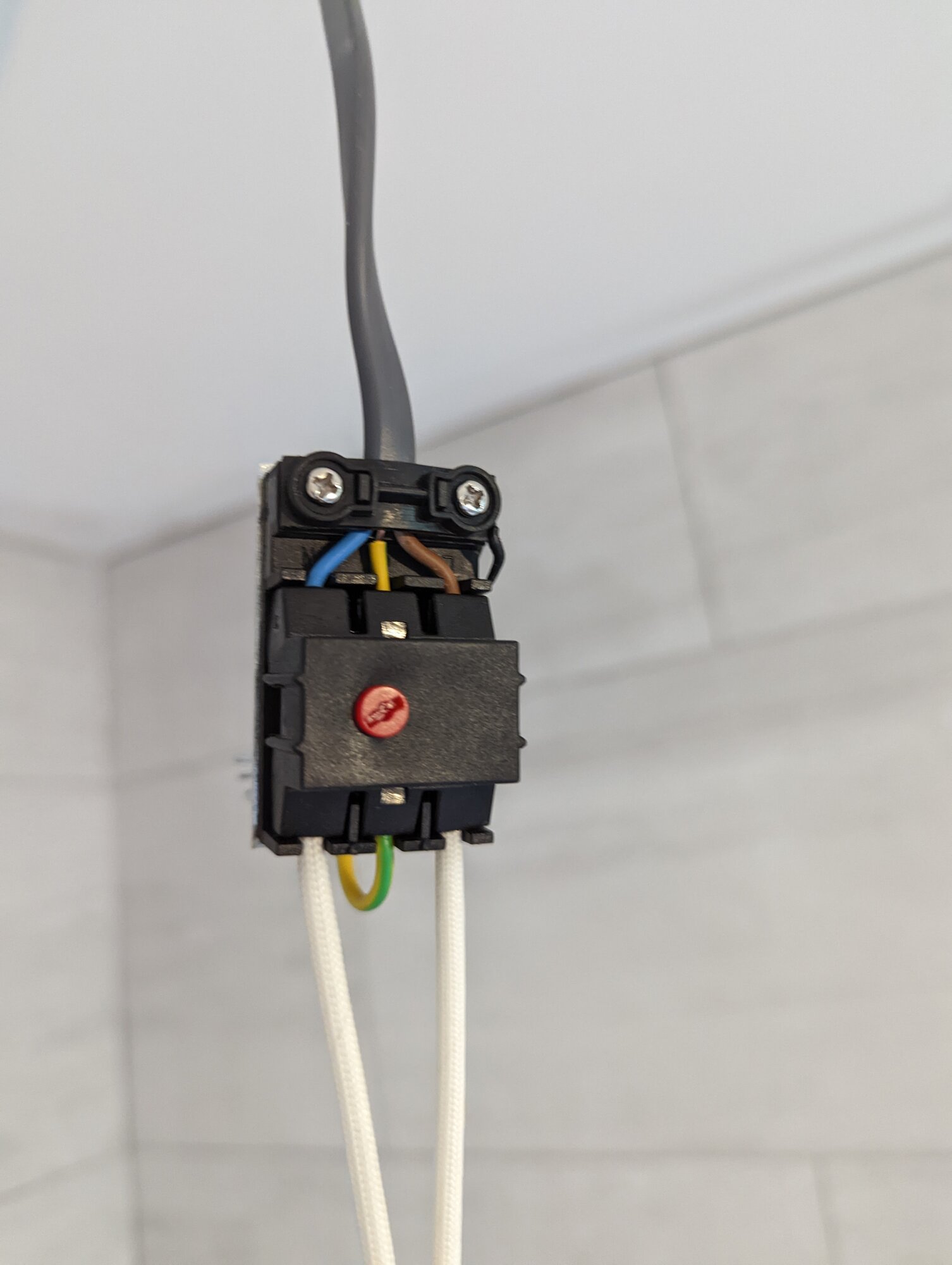

Went to look at a couple of small jobs recently, customer tells me they had a new consumer unit fitted last year but now cant get in touch with the “ electrician “ that did it. At this point the alarm bells were already ringing in my head.
Once i arrived at the property i asked to see the consumer unit only to find the cover wasn't fitted properly as the board had been pulled out of shape when it had been fixed back to the wall. The attached picture is what i found when i removed the cover.
You cant tell from the picture but none of the cable entry's into the consumer unit have any form of grommet protecting them. Multiple circuits are stuffed into the same MCB, despite there being spare ways availble. The first MCB had 2 x 2.5mm and a 6mm T&E made off into it. This turned out to be a ring circuit and a redundant feed that had only been taped up in an attempt to make it safe. It took me about 5 minutes to find this feed as its clipped exterior to the building so there is absolutely no way whoever replaced this consumer unit carried out any form of testing. Also notice the excessive copper on show where it is terminated into the MCB.
I asked the elderly lady if she could remember what she had paid for the work she seemed to think it was around £150. It doesn't sound a lot of money but to her im sure it would have been. Makes me mad that people will install this standard of work and take peoples money.
The good thing is the board looks perfectly reusable and not butchered beyond repair.
So I would just strip all the cables out , re do the board and fitting the correct grommets etc.
Thorough test on all circuits and remove any redundant stuff , re label up the board and complete eicr.
Nice clean days work...

Currently in the process of doing just that. I forgot to mention that there are no labels currently on the board cover, other than one below the main switch. How anybody can make such a poor job of replacing such a consumer unit is beyond me, its not like theres much in it. This was probably all done in less than hour, literally swapped like for like with no concern what any of the circuits might be doing.
Ive also got to check the main gas/water bonds as the clamps aren't visible. The system is a TT ( although it seems PME is a available) with a 6mm to the rod. There is a 16mm green/yellow that you can see in the picture and ive no idea where it goes or what it does. Luckily the customer is very understanding and wants it all put right, its just a shame she has already spent good money on something so poorly done.
