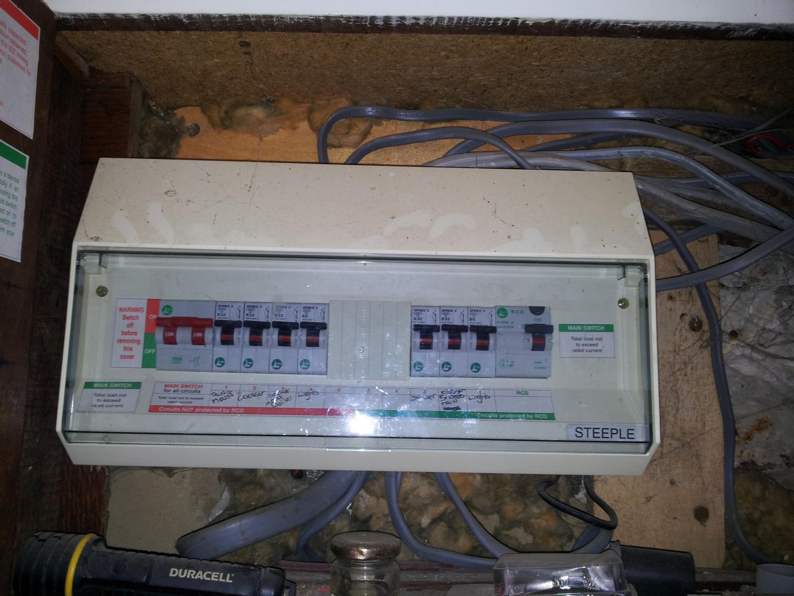

I've found one 32A RCBO (double way), but I know you can get single way Steeple RCBO's as I've seen them, but I just cant see them anymore!!
Does anyone know where to find RCBO's that will fit this Consumer Unit? I need x3 32A and x1 6A...
I have spent quite a while looking!
Ebay has the x1 (double) 32A RCBO. Dont think Denhams do them anymore, will ring tomorrow... anyone?
I know it's not good practise and I have not had to do it yet, but do other RCBO's fit this CU?

That looks a lot like an old GE board with a different badge printed on it.
Yes, have just read that they were GE.

Nope, those in the picture are almost certainly Wylex/Crabtree rebrands, not the same as the GE rebrands in your OP
This is getting confusing! So the ones in the second picture say 'Steeple', but are rebrands and wouldn't fit my board in the first picture?

The first pic of the old steeple E series was indeed GE, the new steeple stuff doesn't fit these boards, Denmans don't do it anymore anyway although it was a wylex rebrand so wylex stuff fits the newer steeple boards.
I've never seen an RCBO for the old E series though.
Looks like I will have to change the board then.. I shall remember this next time I come across an E series!
Thanks for all the help guys..
Have you called Denmans? The grey RCBOs in your last picture look quite modern.
Yep, called Denmans this morning. They have plenty of Steeple RCBO's as in the second picture, but like the others have said, this is a GE board (rebranded as Steeple) and they will not fit. Denmans said they were unaware of any GE RCBO's
