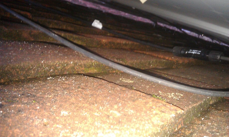

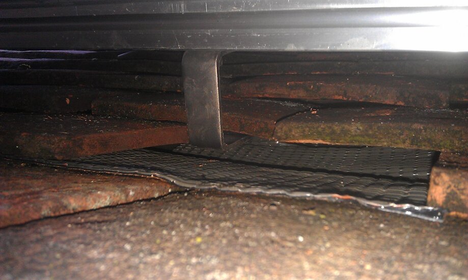

Got a call from a local guy that we quoted for, he went with another company and has now asked me to inspect his install today to see how it was. I've now done that and found a few issues:
1 Only used 12 hooks on a row of 7 panels (no wind calcs provided as far as I know but this is quite a few less than our calcs have ever come up with)
2 Cables left dangling on roof between every panel so they'll suffer from abrasion each time the wind blows them.
3 Tile removed where each hook is placed, bottom is flashed with sticky-backed lead replacement but still a gap around the hook for wind-driven snow or rain to penetrate.

When you say 12 roof hooks, do you mean 12 per rail? Or 6 per rail? We normally install 7-8 on a 7 metre run.
The roof hook solution looks very poor and I would say that this is the main issue with the install.

Only 6 per rail, the least we've ever put is 8 per rail of 7 panels, but sometimes more depending on location.

Re the install: how long are those cables going to last chaffing against those roof tiles?
Without wanting to go into any detail about the PV aspect of the job, at the very least those cables should be secured to meet regs (I haven't got my BGB to hand but there is definitly a requirement within it to ensure cables are secure), If there is a real risk of abrasion or damage occuring to a cable as a result of it's poor installation, the installer is liable to put it right. Both the EAWRs and the Building Regulations call for good workmanship, of course this is subjective, but I can't see many people agreeing that cables loosly strung across a roof is an example of good workmanship.
As for the tiles removed, I can't really comment as I can't see it in my own eyes, but it would worry me that driving rain could easily penetrate as a result. Maybe consulting with a decent roofer would help in your assessment of whether or not their solution is adequate enough to provide good protection from the elements.
If I'm inspecting another electricians work and there are obvious corners cut that affect the safety of an installation, hands down every time I would be advising the client to have the other electrician return to rectify his shoddy and potentially dangerous work!
Put it this way, if you had me round at your gaff to install some outside lights for example and I left the feed for them just loosley strung across the roof and for the hell of it decided to just whip a few roof tiles off, you'd be calling me back round to sort it out I'm guessing! :D
