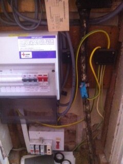

whilst doing a survey for a solar job i noticed something [ElectriciansForums.net] doin a survey any thoughts guys
  • [ElectriciansForums.net] doin a survey
lol the system is a TT no earth the newish board states otherwise as whoever it was has put a clamp on the sheath over the insulated incoming cable so
1 how can it be earthed
2 i would like to see the cert and the ze
3 i think he should have fitted an earth electrode but thought nahh thatll do
