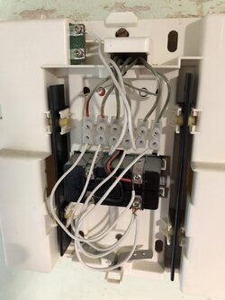

Hi
I’m trying to connect 2 Ring wired doorbells to a chime. Or rather, bypass the chime on the doorbells.
The chime is a Friedland 454. I currently have a standard rear and a front doorbell, both work ok.
In the chime, the wires are currently connected to terminal numbers as follows:
0 - 3 white wires
1 - 1 black wire
2 - No wires
3 - 1 red wire, 1 white wire
Could anyone please help in terms of which terminals I need to connect the Ring jumpers to for front and rear door bells?

That looks like a somewhat modified 454, and I can't make head nor tail of it!
All that you're trying to do, is to connect the incoming power from the transformer directly to the wires to each bell push, so as to feed power to each Ring.
There appears to be six wires coming into you chime, and these will be three 2 core cables - one from the transformer, and one to each door push.
You need to connect one wire from each cable together in a group of three, and then connect the other three together in another group.
The link supplied by Ring is effectively just a short piece of wire, although it has a 'lump' in the middle of it. I don't know for certain what this is, but can only surmise it's a non replaceable fuse. As long as your existing transformer is fused, it should be OK not to fit it.

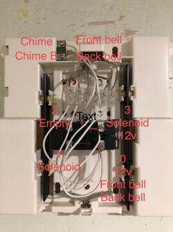

Thanks, I think I have now worked out the layout. Please see attached photo.
if this is correct, am I right in thinking that the jumper cable should go between chime A and 3 for front bell and Chime B and 3 for rear bell?

It looks like terminal 1 is connecting one of the wires from the transformer to one of each wire to the bell pushes already, via terminals 2,4 and 6 of the length of strip connector, labelling them left to right. Leave that exactly like it is.
Disconnect the white wires from 1, 3 and 5 of the strip connector, then connect the Ring link wires between 1 and 3, and 1 and 5 in their place.

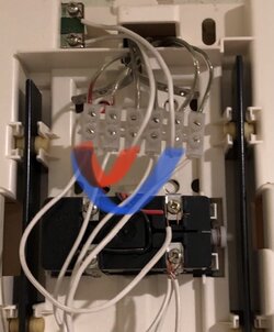

Thanks very much. Just checking my understanding of this I have attached an image with where the Ring cables should go. Red and blue lines.

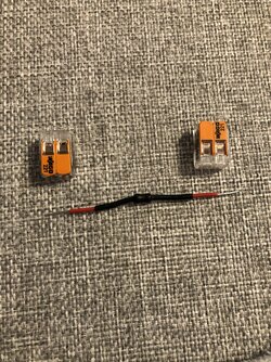

I’ve also attached a photo of the Ring wire and little connection boxes that come with it. Double checking, do I need the little boxes or do I just remove the existing wires and connect the Ring wire directly to the terminals?

`That diagram appears correct. Since you have the 'choc bloc' already there, there's no need to use the Wago connectors at all.
