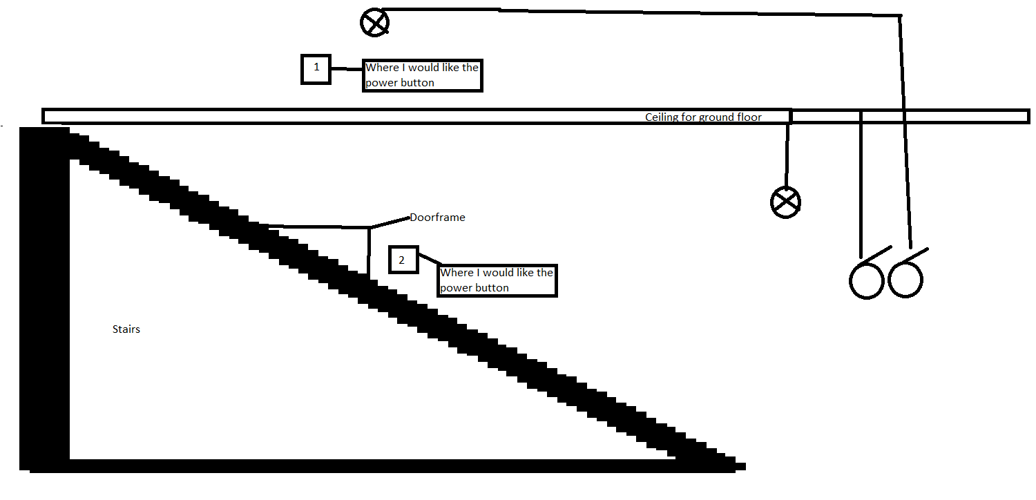

here is the rough layout I think the symbols are correct what I would like wireless switch two (2) to do is to turn both lights on when grandma walks from the main room downstairs (doorframe) to the stairs and when she gets upstairs for wireless switch one (1) to be able to turn both lights off and on when needed. not sure on the exact wiring circuits for the house.
Hour job for an electrician using the Quinetic system if all goes according to plan and a permanent live is available where the receiver needs to be positioned, the only problem could be getting a cable from the receiver too one of the remote lights if its not routed through the same rose. Where is Grandma's house, may have a Forum member near.
