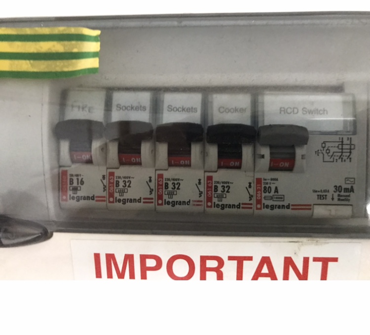

Just looked at a board in a friends house next door to me . I have same board with only one rcd fitted . His has two fitted but I think the extra one has been added at a later date as rcd looks newer than everything else so his is now dual rcd board and everything is covered by rcd . I know you can buy a blank board and put what you want in to suit but can you “ convert “ a single rcd board to a dual . All looks fine but would manufacturers warranty be invalid or anything like that . Tia

Quick answer Yes, no different to replacing a faulty MCB or any other unit in the board, more important is getting a compatible one i.e. busbar lining up correct size for the board in height etc, put in a type A using a type AC is not worth it.

I would expect there already to be 2 neutral bars, and so it is a case of having the correct internal cables to correctly route the N for the new RCD, plus the correct L busbar. So as mentioned above, yes it can be done. And nowadays it should be a Type A RCD, whereas in the past it would have been a Type AC.

You are supposed to seek the Manufacturer's advice because the Board will be type tested with what it was originally supplied with. I realise I didn't directly answer your question the first time. Are you aware of the potential dangers from type AC RCDs ? Chances are the original fitted RCD is type AC. It has been shown that these may be unreliable in a modern installation. By "unreliable" I mean they may not trip when you are receiving an electric shock or your house is about to catch fire. Strange times, manufacturers, NICEIC keeping really quiet about this. Possibly potentialy dangerous type AC Dual RCD Consumer Units on sale at knock down prices to get rid of the stock. Something of a scandal in my opinion. You can identify the RCD by the symbol on it. Type AC has an "S" on its side sine wave only. Type A has the same with a dot-dash line below it. Please take a photo of it and post. You can possibly improve your safety by adding a new RCD and changing the existing one also.

Lets see if we get a picture of the CU and RCD. I would agree best route new CU with future proofing for AFDD

answer to original question: you probably can add an RCD later, I have done this many times in the past, but I would need to do a site visit prior to giving definitive answer
