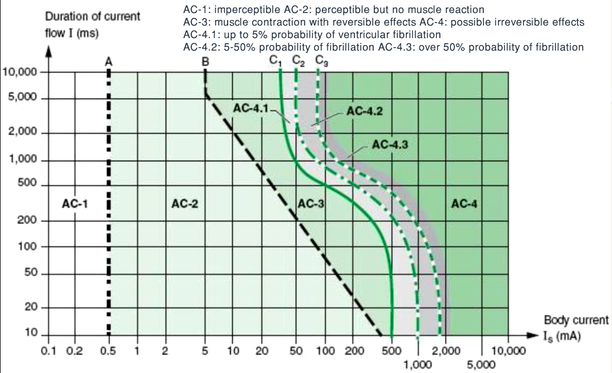

150mA for 40ms is on the limit of "safe" current for the human body (as is 30mA for 300ms) as shown in the below diagram, these values are on the borderline of transferring to involuntary muscle contraction which can be dangerous.
However if someone is touching something then the fault current experienced would be lower due to the human body resistance.
