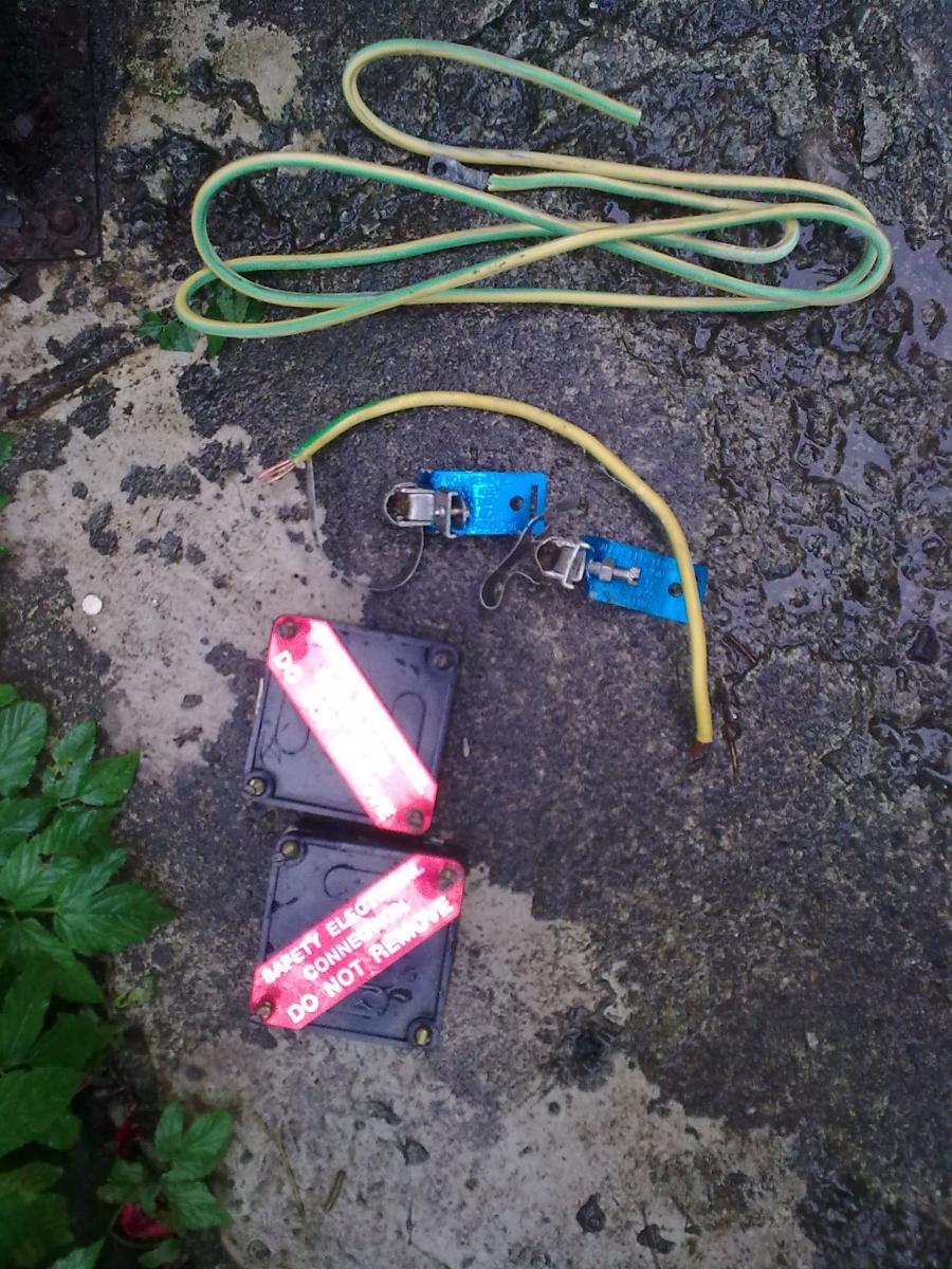

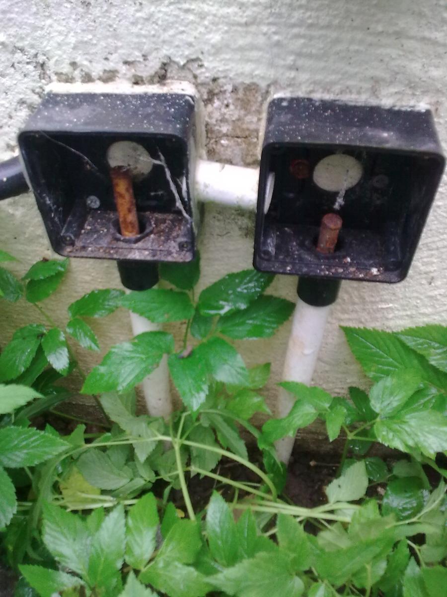

I couldn’t help think about Engineer54’s teachings today when I carried out an EICR and found two earth rods with an RA of 393 ohms.
I pictured him sitting atop Everest, deep in meditation like Buddha, divinely in tune with all TT installations around the world, trying to teach people the path to enlightenment which comes with a lower RA! Saddened by the knowledge of poorly installed, feeble 10mm rods installed at insufficient depth, without separation of the rods exceeding depth… :ihih:
This is a holiday let above a garage. What made me laugh was the person who installed the rods (NICEIC domestic installer), also changed the consumer unit, carried out a PIR and installation certificate. And after fitting a 16th edition board, failed his own work with a code 2 on his PIR because all circuits on a TT weren’t covered by an RCD??? And then noted on his certificates an RA of 283ohms, not to mention a whole load of gibberish I didn’t understand.
What confused me is the house is TNS, and there is a 3 core SWA feeding the Holiday let. The SWA has been terminated into a Wiska, and then connected to meter tails, but the CPC is sitting there unused but connected at the houses MET with a Ze of 0.43ohms? I’ll have that then! Saves messing around with earth rods out in the Welsh sun (rain)! :yes:
Your right, i do sometimes wonder if there are any electricians left in the UK that understand what a TT system is, and what it's there for... lol!!
As you say, ...A total waste of an incompetents time and money!! Perhaps he hoped that fat earth cable would give him a lower Ra reading?? lol!! Looks like there isn't even a meter of those twigs actually in the ground from the photo, and those black earth rod connection boxes wouldn't be lasting too long either, total crap they are!!

View attachment 15146View attachment 15147
