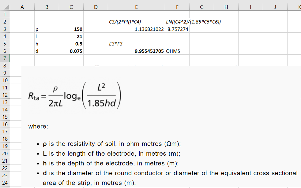

At our church, we've had an inspection of the lightning protection system (LPS), and as I expected the report's come back saying it doesn't comply with LPS standards but "There are hundreds of churches with lightning protection fitted to just the bell towers & spires only, they do not comply with LP standards, but the limited zones of protection provided by them is accepted as the norm, as long as the earth resistance on the system is 10.0 ohms or below."
I suspect most of you are ahead of me here, needless to say our earth rod doesn't give 10 ohms. It's reading 230 ohms ?

I can't see much point trying to get any decent rods in the ground, so tape seems a better bet. I'm thinking if we hire a mini digger over a weekend, we should be able to get a decent length buried - and put some service ducts in while we're at it for other things we've been thinking about.

So at this point, I'm looking at whether there are reasonably easy ways to get down to 10 ohms.
Tape is definitely the easiest as it's a matter of dig a trench, drop it in, backfill and compact. It'll take a while to settle and get full contact, but it's the minimum of excavation.
Mat (yes I already know about the principle) would simply need massive amounts of excavation - though I suppose we could DIY a grid on a lareg grid (not that we have mush distance between the building and boundary wall on that side).
And rods are a non starter in our ground.
Hence asking if people have any direct experience - e.g. how much tape might we need to bury to get down to 10 ohms in damp soil ? Even a rough idea will give me something to go on.
If you take the formula for the cruciform shaped buried conductor (appropriately enough) plug in a typical 150 ohm.m earth resistance, it needs about 36m of buried 16mm^2 conductor (40cm deep, not very senitive to that parameter) to get to 10 ohms.

CEF sell bare copper tape with a csa of 75 sq mm, which should reduce the distance, I'll run the numbers for this later tonight if no-one beats me to it.
Out of interest - which area?
I was going to add that I'm not sure 16mm copper is acceptable for a LPS, as pointed out above typical tape is 75mm^2.
However, if you attempt the adiabatic for a 100kA 10us/350us lightning surge it is about 16mm! For radials off a higher current ring or similar attachment to the down conductor they may be OK. The earth resistance is not so impacted by CSA, more total length.
I've now used formula d from the link that @pc1966 provided which is a straight run of a conductor.
I think I've got this right, I've included the formulas in case you want to recreate it (or so someone else can point out any mistakes!).
It seems to suggest that again with soil resistivity of 150 ohm-meters, 21 metres of 75 sq mm csa tape buried 50cm down would get you to 9.9 ohms.
(If you install all 25m in the pack it comes out as 8.69 ohms)
The main variable is the resistivity of the soil and as you say it's worth checking that in advance.
The soil is always the dominant unknown!
