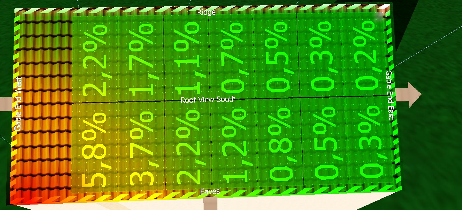

That's really kind, Biggs. This shows my garage roof at EX39, Devon. It is exactly south-facing, at around 39o pitch, and the max area is 8m x 3.9m (this includes eaves overlaps at each end, so usable space is more like <7m x 3.5m. This photo was taken in January, where the shadow height is at its worst. It's like this for around 3 months, but the shadow doesn't land on the roof at all for 3 to 4 months in summer - with every stage in between!
Not even panel manufacturers will tell me how much a thin, vertical, straight shadow will affect a panel and the array it's in! That's really the answer I need...
Okay, estimating the size of the pole, I have run this through PV Sol Expert.
In the layout shown, it calculates an annual loss of 14% through shading.
BiggsSolar, thanks very much for that info. Does your annual loss calc take into account the variation in shading height over the year - ie: the fact that there will be no shading at all over the 'highest' months?

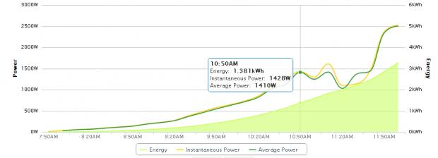

This may not be directly relevant, but I've also been monitoring the effect of a more diffuse shade caused by a silver birch tree on two right hand panels of one 8 panel string (of two strings). I knew the shading was there, but wanted to confirm that was why my new system was not performing as well as a nearby array (same orientation, v.similar size). The graph below shows the jump in output after 12pm when the 1 string that is in shade comes out into full sun (data collected on a clear sky day).
..and here's the results from that day comparing my array output with a nearby system:
LangstrothOther ArrayDelta
WhWhWh
8pm to 12pm285452172363
12 noon to 2pm5575560732
2pm to 4pm44754634159
4pm to 6pm17591186 -573
As you can see, my array when not shaded is producing the same output as it's unshaded near neighbour.
The morning shading though, even though "slight", results in a near halving of output.
(The tree is due to come down btw - it's also shading too much of our garden)
(For info: system size: 4Kw. Two strings of 8 on separate MPP trackers.)

To my thinking, this and what Worcester posted earlier is actually very relevant. What it says to me is that a hard shadow will knock out a set of bypass diodes, a panel or several panels and, if several panels suffer from hard shading, it may also take out a string which would lead to a partial or a complete inverter shut down.
Soft shading (due to diffused objects such as trees or structures which are some distance away) may not be enough to trigger the bypass diodes but will be enough to reduce the output of the string until a point where the bypass diodes trigger (about 10.50am).
The panel output doesn't increase then until about 11.30am when, I have to assume, the sun has moved enough to bypass the shading. At this point, we see almost a doubling of power output as the shaded array comes back on line. I don't believe that the string shut down though. Based upon 250W per panel, it seems like about 2 panels came on line at about 11.20 and the rest came back at about 11.30 (smoothed out on the graph).
Had the shading not taken place I suspect the gradual increase in harvest would have continued in a linear fashion until reaching the systems capability and we would have seen a smooth and gradual curve similar to what we saw before 10.50.
Something is also occurring between 10.50 and 11.30: the variation in power is pretty wild. I suspect that this is panels or sections of panels bypassing (or otherwise) as the shade takes more and more of a hold on the array. Smoothed out as it is, you can see jumps in power level as something like 4 panels are switching in and out and then the whole of the rest of the array suddenly comes on stream at about 11.30.
When my micro inverters finally arrive (something of a moving target) I will try to produce something similar. If nothing else, I should be able to track what is happening panel by panel as shade takes effect.
