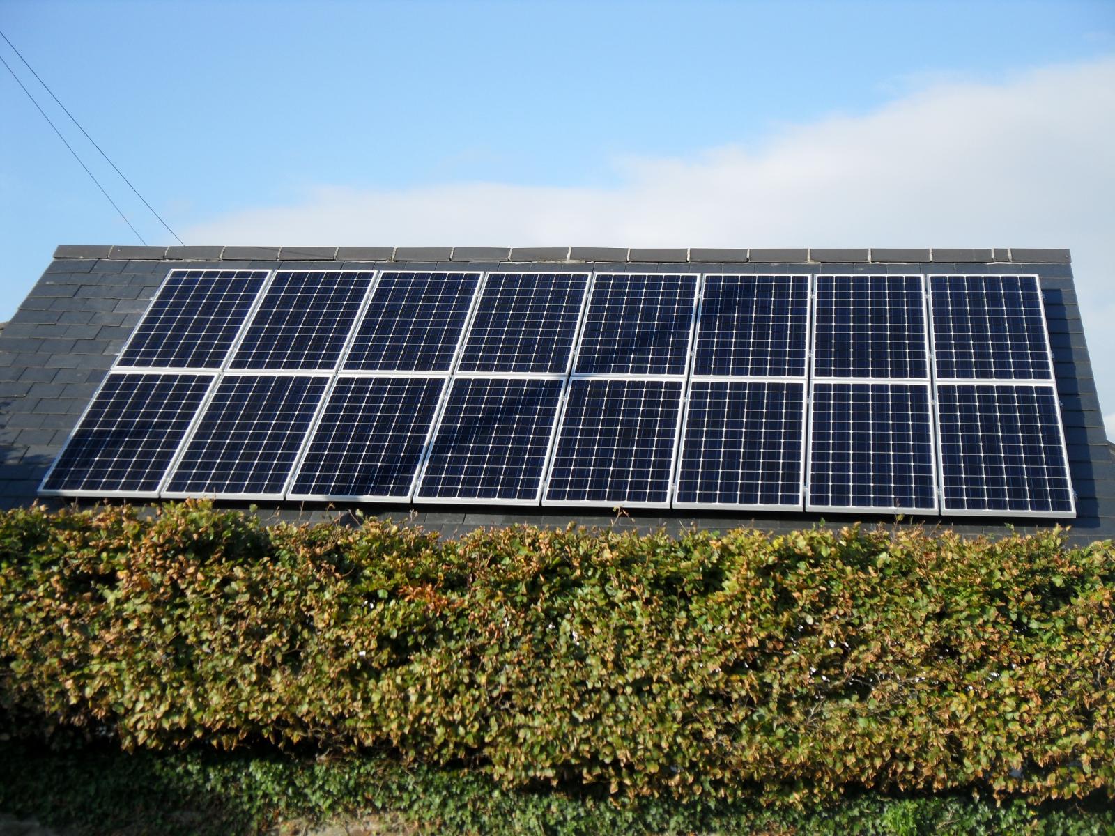

Somewhat delayed further feedback from me on this - sorry. Due to pretty cloudy conditions recently with no shadows being cast...
Took these two readings yesterday, 22nd Oct. Bright sunshine, well-defined shadows, but not completely 'blue' skies.
Left hand photo shows shading at 3pm, right hand at 4.10pm.
To recap, the array is split left & right, 8 panels each side.
At 3pm, LH array: 335W RH array: 1201W
At 4.10pm, LH array: 404W RH array: 510W
This info is for others to digest, and I have found the responses genuinely interesting.
The bottom line for me, of course, is that despite the lowish Autumn sun, the shadows in the afternoon, and the overwhelmingly cloudy & overcast weather since the install, it has still produced 192kWh in 25 days! So even under these 'worst-case' conditions (I'll have no shadow at all over the highest producing Summer months) , it is still on target! That, I find, is pretty darn impressive... :angel_smile:

These results are consistent with the tests we have done. I was surprised that the pole appeared to be having less of an impact on your previous posts but clearly the shadow cast by the pole is larger in these photos. The drop in production from 1201w to 510w as the shadow moves along it is dramatic and demonstrates the importance of getting the design right in the first place.

Those two pictures that you took Scooby are really interesting. For me it's another good illustration of the effects of shading. I'll assume for a moment that the power produced by the sun is constant at both times. I know it isn't, but for the sake of the analysis, I'll assume that it is. Your reference is the right hand array in the first picture which is producing 1.2KW. The left hand array, at that time has one panel where the bypass diodes have probably isolated the output and three more that are marginal. Worst case, we might expect 4 of the 8 panels turned off. The power produced on the left hand panel, at just 335W is about 28% of the output of the right hand panel.
Move forward to the later picture now. In this one the effect is almost symmetrical on both panels. Theoretically, with two panels of out 8 affected on each array, the power produced should be 6/8 * 1201 KW = 900W. However, what is produced is roughly half of that.
So, what is happening and why is it different to your pictures from some time back? My theory is this: these two pictures, at a time when the light levels are lower anyway, show situations where the bypass diodes are not triggering. Taking the RH array in the first picture as the reference, in all of the other situations the effect of shading is constraining the harvest to the performance of the worst panel because the difference in harvest between the light and shade is less than 20% of the panel capability (using the Solaredge numbers). As the diodes are not triggering, the whole array is being constrained to the performance capability of the worst panel.
So, where the irradiance is higher, the difference in power between best and worst sections exceeds the 20% value and the diodes trigger. So, a nice sunny day in the middle of summer would do the trick. However, early and late in the year or early or late in the day at other times, the diodes may not trigger and the power harvest will be reduced. Luckily though, this is at a time when the harvest is low anyway - so the loss is less of an issue.
Just a hypothesis... does this make sense or are there different factors at play here?
Hi Series. What you say makes sense to me, tho' I don't have the knowledge to confirm your hypothesis! Certainly, the LH array shows a much bigger reduction in output compared to my earlier - first - post on this.
I have to say I was pretty amazed at how little the original (last week's) effect of the shading was; it was slightly earlier - at 2.30 - and the shadow was affecting only 2 panels, one fully, and the other by less than a half, but still... The example above is half an hour later; as the picture shows, a total of 4 panels are now affected to some degree. However, the overall light levels between this one and last week's must have been pretty close in both cases as the RH array had outputs of 1201W and 1170W respectively.
I would suggest that comparing the 4.10 example with the others has to be treated with some caution as the light angle has changed a fair bit, but how much effect this has I don't know.
