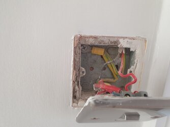

Posting this more as a discussion than seeking advice, as I've already fixed the issue.
EICR on a house which at some point had been 'done up' with metal face plates for all the switches. When checked with a wander lead R2 was within spec on the ones I tested, but when taking a random one off found the earth to the back box only - so then checked them all and not a single one had been brought forward to the nice obvious earth terminal on the switch :facepalm:
[ElectriciansForums.net] EICR Code for metal light switches with earth to backbox
I remade all the earths to the front plates anyway in this case, but was wondering what code people might give this if they found it on a job where they could not do remedials? It's sort of the opposite of the old argument about needing to earth the backbox or add a flylead.
Would people consider an adequate reading of R2 to the front of the switch when correctly installed as not needing a code? Or automatic C2 once you saw the lack of cable to the plate terminal?
In this case, one of the back boxes was metal with insulated lugs anyway, so that would have been an immediate C2. But I remade them all anyway as I was also working in the place.
Does show the limitation of R2 checks on everything, where you aren't removing every plate. Didn't help in this case that the bodger who'd done it had half buried all the plates into the wall to discourage ever removing them!

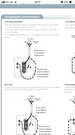

the reasons i would give it a C3 is that it does not comply with MI ( as westie pointed out), and if the screws were removed for decorating or whatever, a fault on the switch would not trip MCB. therefore it "is improvement recommended. ", because i say so (smiley).
Class 1 exposed conductive parts require earthing, if it’s earthed In situ then it’s no code.
best practice is to earth the plate directly however i dont see the issue if it’s earthed full stop by one way or another.
The regulations will not tell you how to earth it other than it requires earthing.
The instructions with the accessory will demonstrate a cpc to the front plate.
Very interesting discussion, and I can probably see the validity of every view. Thats the 'joy' of doing EICRs to a consistent standard.
My concern would be the worry that screws might come loose or a lug break with constant use of the switch (something that doesn't happen with CUs so much).
but if an R2 to the front plate is satisfactory, then it is probably acceptable to consider that effectively earthed without necessarily needing to remove it to check the earthing connection....
However, if I remove a front plate and find the earth not to the plate, personally I'd still feel duty bound to correct it there and then to avoid any further thought.
