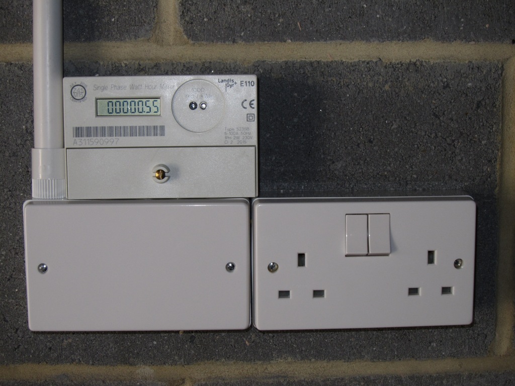

I have a job which has within it's specification a consumption meter, has anyone fitted one of late and have any recommendations? It is going on a supply for external lighting to reimburse someone for electricity used.

Used to fit many,
100A Single Phase Check Meter | ElectricalDirect - https://www.electricaldirect.co.uk/product/100a-single-phase-check-meter-436268?vat=1&shopping=true&mkwid=s_dc&pcrid=244074453065&pkw=&pmt=&gclid=EAIaIQobChMI3omHkbGq2QIVEt0bCh2ZwwVCEAkYASABEgKz0vD_BwE&gclsrc=aw.ds
Be aware the terminals on pretty much all meters are designed for tails therefore in order keep it safe drill out a double plastic back box to suit meter terminal layout, mount meter above and make earth connection it the back box.
Position in easiest position, either at the CU/DB or closer the accessory, really doesn't matter.
The meters in the link above are not new, they are zeroed, so may be a bit grubby but usually clean up ok with baby wipes.
hope this helps.
Like this. Installed for a fridge in a garage on the communal supply for garage door openers.
