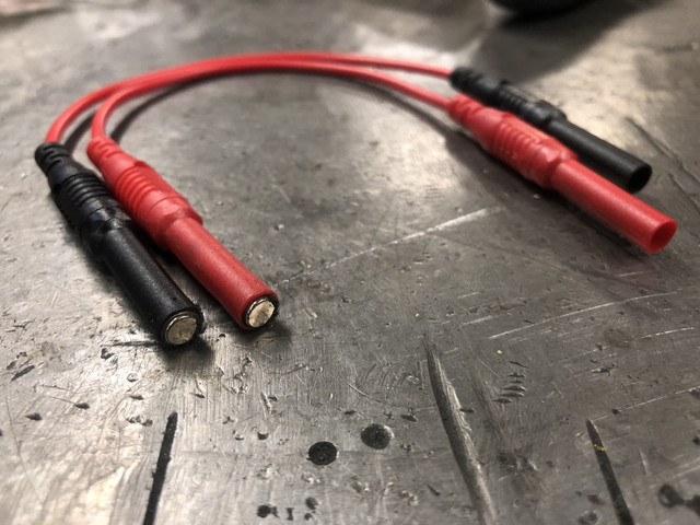

Every day for the last year I’ve been thinking I need some test probes for my multimeter that have a small magnet in the end to connect to the screws on contactors, MCB’s etc.
I found these on eBay, but the diameter is 7.5mm so a bit big for some connection screw holes.
Has anyone seen any anywhere else?
Thanks.
Test Probes Electrical Tester Fluke Megger Metrel Kewtech Seaward others 4mm | eBay - https://rover.ebay.com/rover/0/0/0?mpre=https%3A%2F%2Fwww.ebay.co.uk%2Fulk%2Fitm%2F282134794461
Quickly connect to contactor, PKZ, PLC, drive terminal etc to avoid holding a probe on it while you test around for the other end, usually 10 meters away in a different control panel!

I get the logic,and some of the tiny magnets available on bag/clothing fasteners and kids building kits,would do,but if you are connecting one end,as in long-lead testing,i would want something a bit more reliable,on the end i couldn't see :)
I made something like this for a particular job. I soldered a lead to a 2mm wide strip of thin copper foil, hooked it over one end of a 3mm diameter neodymium magnet, then sleeved it with heatshrink leaving the foil-covered end of the magnet projecting by 1mm.
