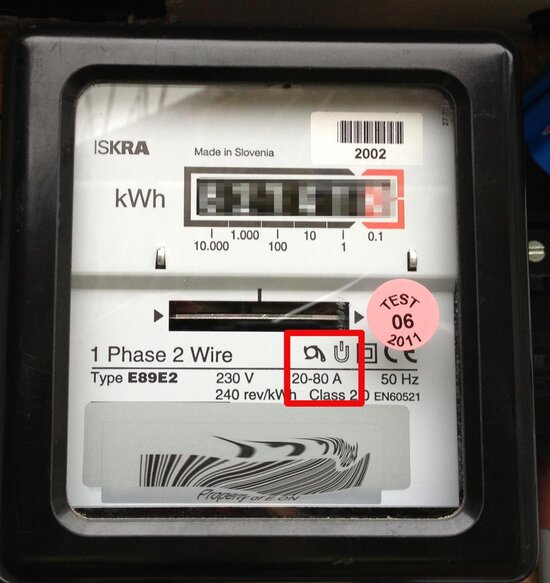

Ive been to a couple of customers houses who have a pv system installed, and who are both complaining that there bills don't go down. Ive checked out their systems and they all seem like they are performing well, but what bugs me is there incoming electricity meter is the one with dials (like you find in your car milometer) Both customers moan like hell because the dials dont go backwards when the sytem is generating electricity, unlike their old spinning disc meter.
Why is this the case? How do these meters work exactly. When the pv system is generating electricity, shouldnt the dials go backwords? confuses the hell out of me.
Dials shouldn't go backwards. Meters whose dials actually go backwards should be replaced. (by the supplier, foc)
The 'old' spinning meters some did, in that case they were not just using the power and exporting it they were effectively aslo getting a 'double credit' when exported, as they would then have to use up the backward amount just to get to 'null'
They get paid 1) to generate and 2) deemed export, i.e assumed 50% of generated. and then on top of that they can use all that they are generating AT THE TIME THEY GENERATE IT for free, nada, zilch..
So if the meter goes backward for every 1kWh that it goes backward they are 'stealing' 1kWh from their supplier.
Later spinning disc meters have a ratchet on the numbers so the disc goes backward but the numbers don't so nothing is being 'stolen'
Some of the newer electronic meters, can also detect reverese flow i.e. when exporting and will come up with an 'red' message = Reverse Energy Detected - what you'd expect, and some have multiple register to actually record the export.
See attached image - meter even has a (I've highlighted it) ratchet symbol on it to tell you :)
