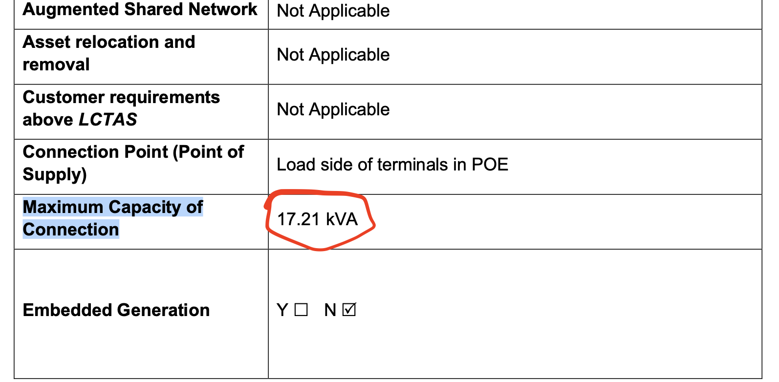

Hi Julie, yes, I am 100% sure it's three phases, so why total power is less than 18 kVA (see the attachment)?
My requested maximum demand is about 80A per phase for three phases of electricity connection. My drawing power is about 80A per phase.
Is it safe to get a total 17.21 kVA power supply?
I attached the screenshot. Many thanks.

17.21 kVA is 25A per phase on a three phase supply if the 17.21 kVA is the total 3 phase power.
17.21 kVA per phase would be circ 75A per phase.
I suspect the figures are wrong, are they quoting for a single phase supply, or have they just mixed up the figures between single and three phase?
You would need to confirm with them.
Do you have the whole of the specification (with supplier and site/customer details removed) - the extract doesn't contain any real information.
Yes, 17.21 kVA is the total 3 phase power.
“ 17.21 kVA per phase would be circ 75A per phase.”
How did you calculate this? If per phase, then using line to neutral voltage which is 230V right?

The standard connection is up to 100A single phase or up to 100A per phase on three-phase.
However in rural locations this could be limited to 32A (or 32A per phase) and in non-rural locations is normally limited by a fuse to 80A as a maximum (could be 45A, 60A, 63A.....)
To calculate Amps from kVA
Single phase
I = VA / Volts - so convert kVA to VA (x 1000) then divide by the voltage (normally 230V)
So 17.21 kVA single phase
17.21kVA x1000 = 17210VA
17210VA / 230V = 74.83A
Three-phase
Two ways
1)
Divide the total three phase capacity by 3 then continue as per single phase as above
17.21kVA / 3 = 5.737kVA per phase
5.737kVA x 1000 = 5737VA
5737VA / 230V = 24.9A per phase
2)
Convert kVA to VA
Use the following calculation
I = VA / ( L-L Voltage x sqrt(3))
L-L Voltage is normally 400V (actually 230V x sqrt(3) = 398V)
17210 / ( 400 x sqrt(3)) = 24.9A per phase
The square root of 3 is roughly 1.73
