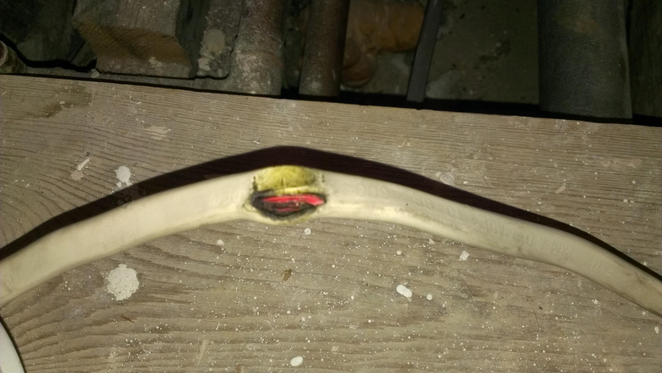

Just to illustrate Richard Burns' point.....
[ElectriciansForums.net] English Heritage
This cable was laid over a central heating pipe.

Running a cable in a hot environment will derate the cable current carrying capacity and lower the life expectancy of the cable, and if hot enough melt the sheath and insulation and cause a short circuit.
