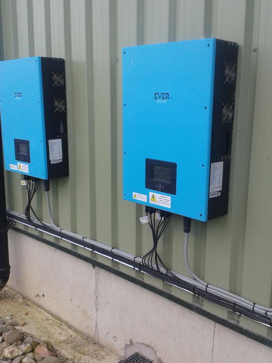

Can anyone help me with finding a pdf of the installation manual for an eversolar 17000tl
I've been on lots of sites and can't seem to find a proper manual just data sheets,
I've been asked to take a look at a 50 kw system which has issues, and had a look for a manual last night gave up in the end hoping that there would be one on site but no luck and customer doesn't think he has a handover pack
Also any thoughts. on these inverters good/ bad or common issues with these?
The building the array is on had an unrelated fire, and the fire service cut the Dc cables, after receiving shocks
someone from the installing firm returned to re string the arrays , but it was an installer and not an electrician so I don't think it was tested again
He decided to change the No of modules per string I'm not sure why it was changed from the original design but the company I'm doing this for say its been run through a design program and its ok
So instead of the original strings I think 2 x 22 and 2 x 13, each inverter is now on 4 strings of 17 , this doesn't appear to be an issue as the inverter is rated for strings max Dc 900v, here there is 2 strings to each input
I have checked the mains side and no issues with the supply, except for lack of an Rcd as its TT, original installing company has been informed and apparently they're sending one.
However the way the strings were wired through the isolators was not correct ,
So I've redone 2 inverters and am returning to do the 3rd tomorrow, this one was not working when I first went there so as yet I don't know what the problem is,
However all the strings had voltages which varied slightly 580 ish volts but were 60v less than the calculated voltage for the strings. 38.2 v x17 modules 649 v (in good sunshine with no shading)
Now I know this figure usually isn't always exactly what you will see when testing but I've never seen it vary by this much before except for the obvious , ie roofer has missed a panel, which if true in this case has happened on every string?????
But again I would only expect to find one modules voltage missing ie 38v rather than 60v
also I'm seeing small stray voltages of upto 10v to earth, so tomorrow I'm going to check voltage , IR etc at the array and test everything again I'm guessing its not going to be an obvious fault here!

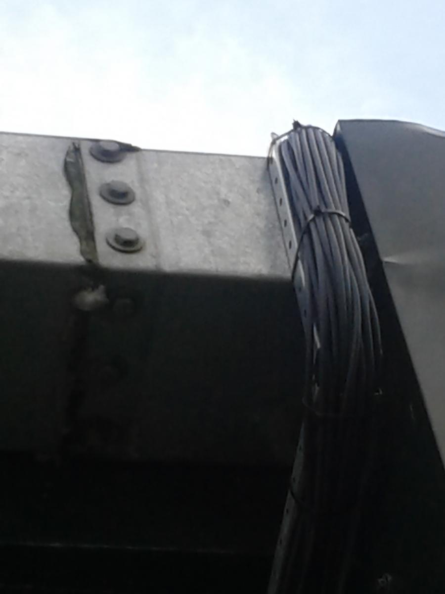

Cable tray was 75mm with 24 6mm DC cables spilling over and marks on the cables from the tekscrews they'd used to fix it,
roughly cable tied once every metre, DC cables just slung loose on the roof at the top edge of the array

I've told the customer about some of the things I think need changing here ie departures from regs and suggested he gives the company the chance to put things right

-0.34%/K Voc temp coefficient is fairly standard, in full sun the panels could well be about 30K above the rated temperature - ie 55 degrees C, so around 10%below the nominal voltage, which on a string of 649V nominal voltage would mean the voltage would be around 65V below the nominal, so there's nothing particularly unusual about that reading, it;s pretty much bang on what it should be.
