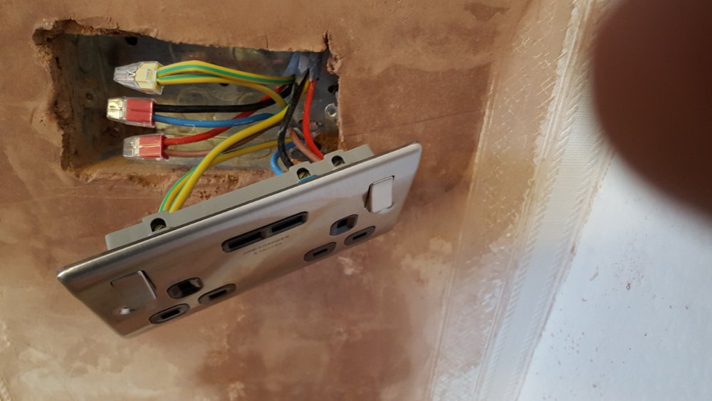

wagos for me. here's one i made earlier. :) :) :)
  • [ElectriciansForums.net] Extending a ring main wagos or crimps
