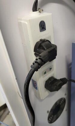

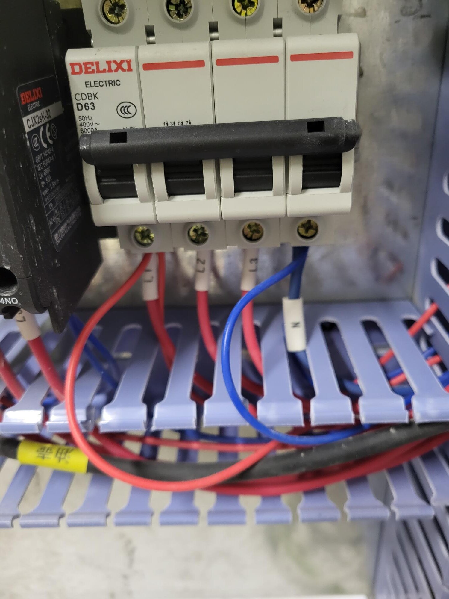

We’ve had a new CNC Machine from China arrive this week. It came with a monitor and a tower to run the software. The monitor and tower were already plugged in to an extension lead that was wired through the slotted trunking, I took all the lids off and traced the extension lead cable to find it being fed from the 63A TP+N MCB/Main Switch. No CPC, just live and neutral. Please see attached photos.
My plan is to reroute a socket that's on a radial circuit at the back of the machine on the wall into the control panel for the monitor and tower to utilise. The radial circuit is on a 20A RCBO.
So I suppose my questions are; how dangerous is what the Chinese have done and why would they do that? Could the extension lead have drawn the full 63A?
Thanks very much.

Doesn't look good as those plugs appear to have a sliding earth contact and aren't suitable for that socket the IT equipment will almost definitely need an earth. Fit a four way extension and use 13A plugs.
I would also be contacting the supplier.

Thanks for the advice Westward. Will definitely be fitting fused plugs with a CPC present for the IT equipment.
The answer is dangerous. Those EU/USA style plugs and sockets have no fuse and are expected to be fed from, at most, a 20A C-curve MCB.
If they only feed internal equipment then you probably don't need RCD protection, but if they are feeding stuff that is separate like a monitor, etc, I would say they should have protection. If you can fit a single module 16A RCBO in there after the 63A D MCB to feed your sockets that would be far better.
As @westward10 has already mentioned it must be earthed as well, and you should be using sockets that are approved for UK usage so either 13A plugs/sockets or 10A IEC style (in which case fit a 10A RCBO, etc).
Very
Because a) they don't know better, partly due to b) they don't care, with a good dose of c) it was the quick and cheap way to do it.
For a while yes, and depending on cable lengths together with Zs, it's possible it could have taken a very significant fault current for ... a long time to indefinite without tripping the supply. Of course, the extension lead would get very hot, melting it's own insulation and creating smoke - but the bigger issue is that it would also damage all the wiring it shares a trunking with which would very quickly turn into a significant repair job.
As others have mentioned, that combination of plug and socket is not earthed, and the IT equipment (at least the PC, the monitor may be Class II) must be earthed.
Is there no spare DIN rail you could squeeze an extra MCB (or RCBO) onto for a suitably protected supply ? Ideally you don't want multiple unrelated supplies going into one machine - creates scope for someone to miss isolating something.
I would suggest that you need to look over the rest of the machine. If they did this, what else have they done that might not be safe ?

Those 3 phase outgoing wires look really thin to be connected to a D63 MCB!
Good point, they do look a bit 6mm-ish when you mention it, and that is not going to last long enough for a D63 to trip!
It might, on a good day and with a fine Zs behind it, trip on a short/fault, but not for overload!
